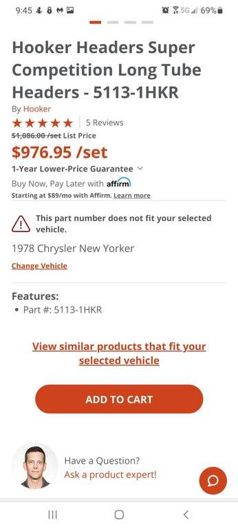

Well, that is what I thought as well. About a week ago, my dad and I decided to take the risk and order these headers, as they fit on a 78 NYB on this site. Here is the link to that NYB: 78 New Yorker Brougham 440 Survivor. The owner of that Formal stated that he owned these headers: Hooker 5113-1HKR Hooker Super Competition Long Tube Headers - Ceramic Coated. So, I went ahead and order those headers.
Here is the interesting part though. As you can see on the site, these headers fit 68-74 C-Bodies, but not anything past 74. I called Holley and asked why, and the service aide stated that the only reason that they would not fit a Formal post-1974 is because of emissions regulations, not because of fitment issues. So I decided to order them and see what happens, and return them if needed. When I received them though, they also came with an instructions list. And as you can see below, the instructions state that they fit formals up to 1977. Of course, it does not include Chrysler, as Chryslers usually are not the market for performance products, but it does state that it fits C-Bodies up to 1977. So, I don't know how this occurred, as the website clearly stops at 1974, but I am very happy about this, as it means that it likely fits my car. Since your NYB is a 78, I know that these would fit as the link above shows these headers already on a 78.

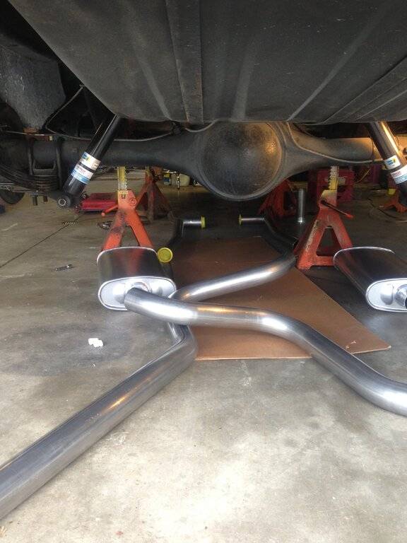

Well, I got a call from my mechanic yesterday, and he got them in! The exhaust was fabricated today (going out the back), and I should be able to pick it up tomorrow. Within the next week I will have pictures and more info about it, but they are installed! Big win for the Formal community!
