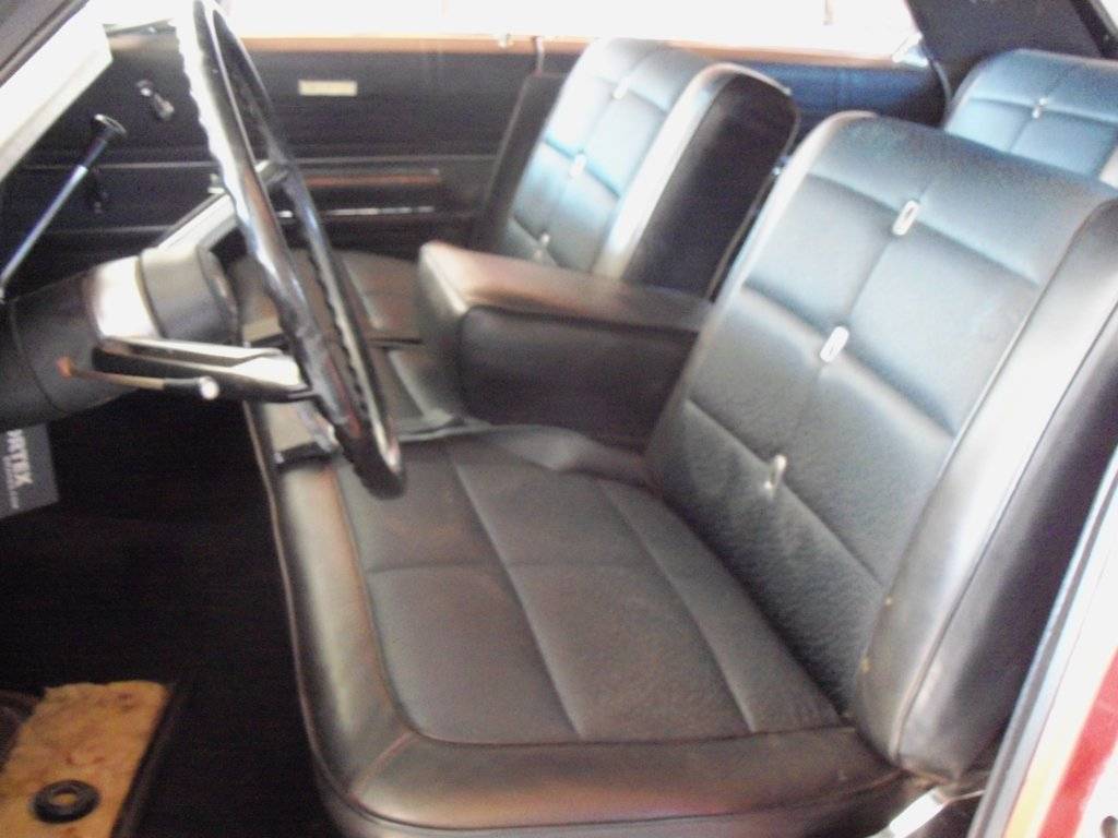

I upgraded my basic bench seat frame for a power seat frame mounted my original seat onto it.
Looks original and I can recline the seat on long trips.

I have individual buckets now fyi with a center console with flip down arm rest. The seat has a latch on the side to easily lean the seat forward for rear entry. So that would likely be a consideration for whatever seats I get as well. Not that I have people in the back often but when I do would be a pain if they couldn't use the latch to get themselves out easily if they needed to.
