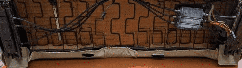

The motor and transmission mechanisms, combined, can be quite wide as they sit between the seat tracks. THIS can limit your possible candidates for seat tracks. The contours/angles/elevation changes in the tracks where they bolt to the floorpan will bary with each generation of body, as to model years.

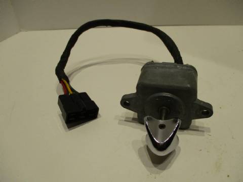

Doubtful that the guts of the joystick-style switch (which was 67 and prior - or 68 and prior?) was the same as the 3 side-by-side switch style.

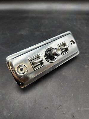

There is going to be a difference in the mechanicals or guts of these two switches. I can't see how any of their internal parts could interchange:
BTW, a good substitute for those not looking for strict originality would be these:
These are GM, the one pictured is from Cadillac (1966 - 1976). The toggle switch part looks to be the same from 1960 to 1981 but the outer bezel would vary.
After rebuilding the 62-68 version with hte transmission and joystick I'm guessing the 69-78 system would have less parts to fail. THe old style has multiple small gears in the transmission that could strip and for sure get gummed up. Plus it uses the solenoids that use electric coils to force certain gears to engage. Like a starter. They can fail.

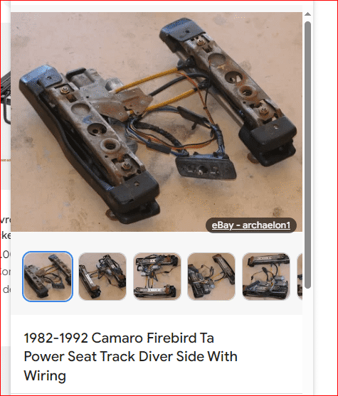

But I bet a newer 80s truck system would work too. I used the GM seat tracks below on my 68 bucket seats. Work great. I'll do a write up once I replace the passenger side. BTW MoparMans switch suggestion is exactly what is used for the tracks I used. Just not in chrome.

GM seatracks

GM seatracks
I went to Pull a part found a 72 Caddy (power bench seat car). But the switch and motor were gone. Was it hard to adapt the gm track to the mopar seat and floor pan ? I have tought about using GM parts ( more of them still around ). I have watch youtube videos on GM system How to work on transmission/ how to work on switch. does not look to hard.
