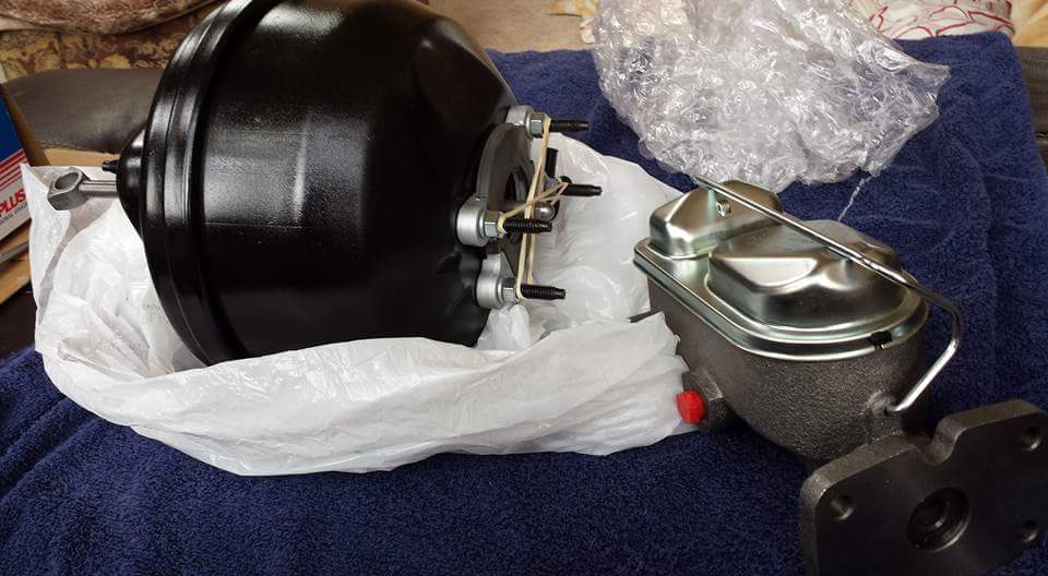

I had same problem on my Imperial. I decided to go with new master and rebuilt booster...think my master was 75-100 bucks.
Just found a pic of the combo before install.
