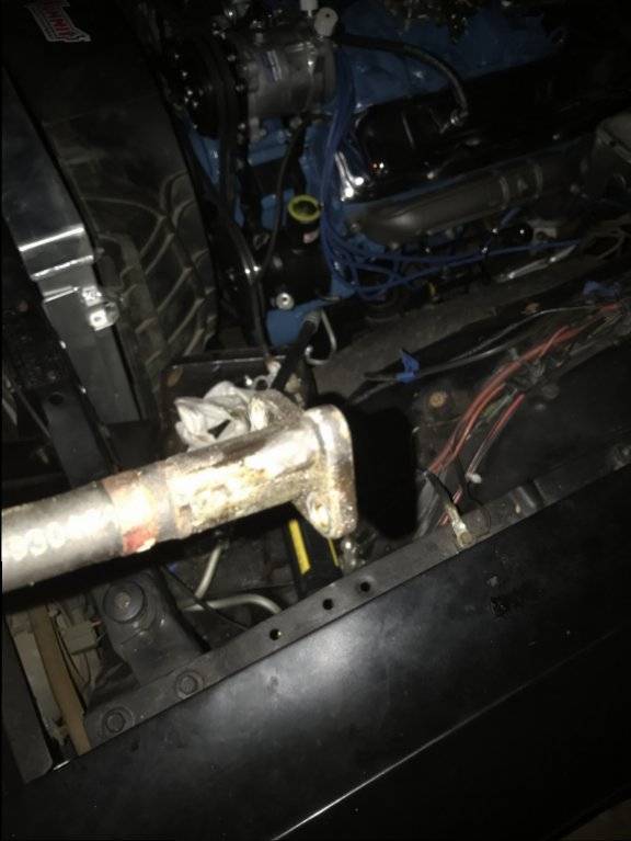

Hey all,
Looking for a power steering control/metering valve for a formal (74-77). I'm sure many diff body styles and years would work.?.?.
Piece pictured in top right corner. (Piece the return hose attaches to on the gear).
Thanks!
No, reman gear already installed. Forgot to remove the valve when turning the old one in for the core... Ima jackass lol....

I can just mention experience swapping the control valve housing. The fittings varied over the years. As I recall, my 65 cars (both A & C body) use a large return hose ~1/2"ID to an aluminum barb fitting w/ 2 mount bolts. It has a check valve inside. The H.P. fitting is an SAE male flare. A 74 gear has a smaller ~3/8" ID return barb that screws in and H.P. fitting is a female O-ring port. That looks more like your photo. The fittings and hoses similarly varied w/ the p.s. pumps. I dealt with this when changing from a TRW to Federal p.s. pump in my 65 Dart. Fortunately, I had a 74 gear on hand. The variance is why your rebuild didn't come w/ the valve housing. Re the steering gear, all C-bodies were the same ~63 to ~78, and the same as 73+ A & B body, though Pitman arms varied.

I don't need the valve itself, I just need the port the return hose attaches to, with bolts. Didn't think finding one would be such a pain!

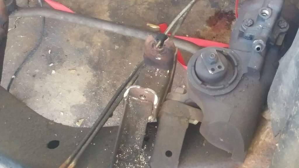

A buddy has an 81 imperial I'm gonna go pull one off of tonight. I checked it out last night in the dark. Looks like it could work. Instead of the hose outlet facing up, it come out horizontal with the gear. Shouldn't be a problem as long as it boots up to my gear... hopefully.
Success! The one off my buddies Imperial will work. Can't beat the price of free neither lol
Still in the car. Cars have been sitting in his back yard for at least 20 years. Was fun getting to it. Don't like going back there in the summer months. Don't know what's hanging around in that jungle lol
