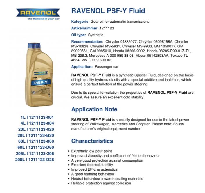

Your FSM will say not to use ATF as PS fluid, but what they mean is - don't use "Type-A" AFT as PS fluid. But they really didn't have to mention the "Type A" part because, well, that's a given that it was Type A they were talking about. Maybe that's when (and why?) Ford came out with Type F ATF? Which I believe I've read is what was recommended years ago for the 727?
The FSM will specify mopar 2084329 as the PS fluid (and someone is selling what they claim is an NOS can of the stuff on ebay currently), and if you search for that on the web you'll find lots of people asking what the modern equivalent is, and there will be no authoritative answer to that question as far as I can find.
