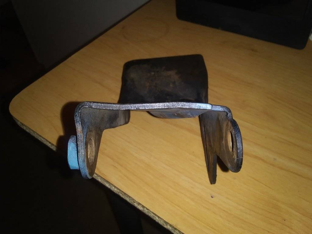

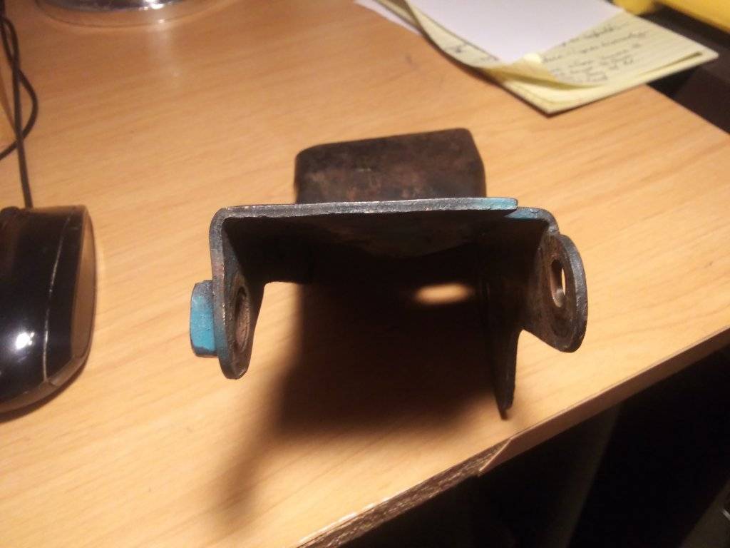

Now another question arises. Although everything appears to be aligned, the bracket that mounts the pump to the water pump housing appears to be mangled. This can't be normal?
It looks warped for sure, but may be remedied with some good surfaces and plenty pressure. Or, you might go junkyarding. I like that option often.
Agree. Abnormal

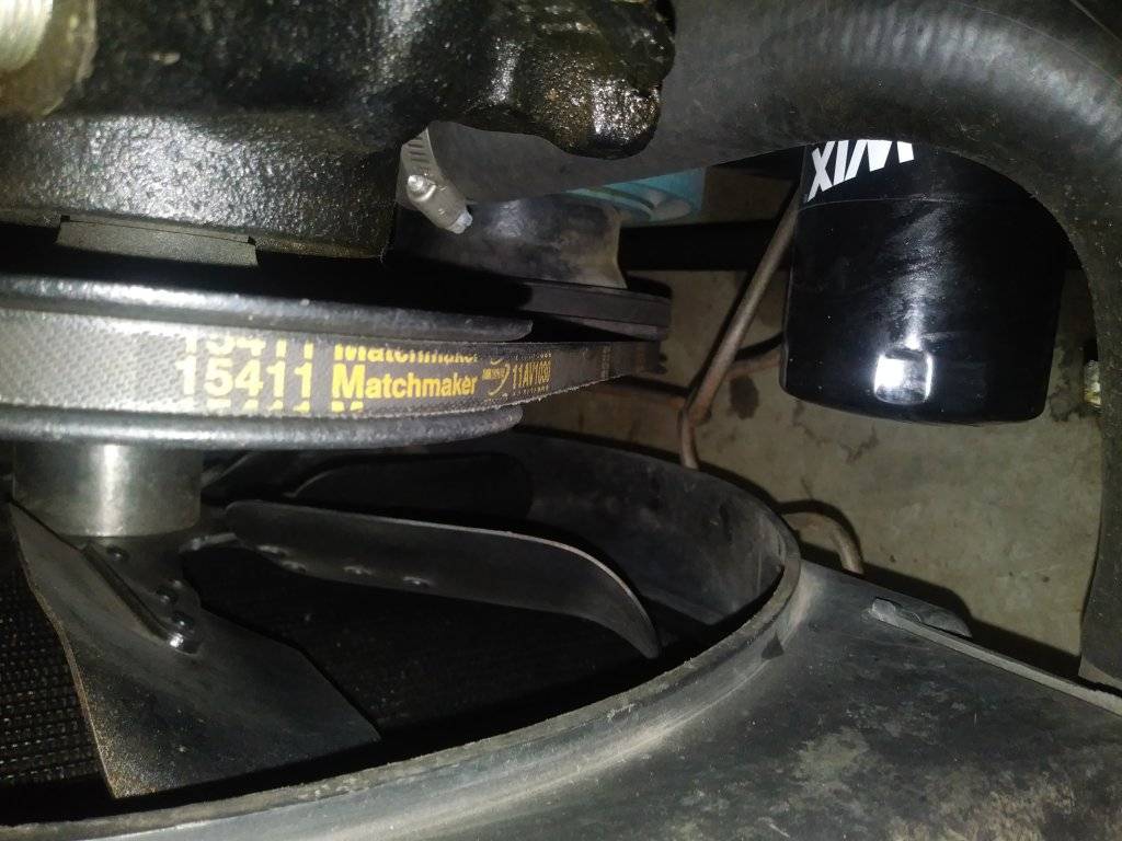

Just a tip for folks that go with the TRW aftermarket pump brackets for big block 66 and up ;
You will need a different size belt.
I use a Goodyear Gatorback 15411 or equivalent if you cross the numbers.
I had done 4 of these "upgrades" and the brackets are by far much better than the sloppy originals.

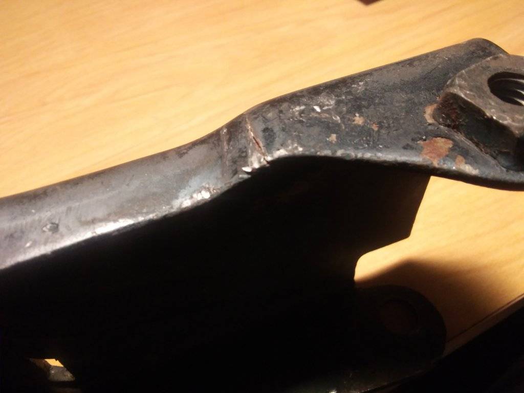

I started flattening out the bracket and discovered a crack. Frell! It's got rust in it, so it's been there a while.

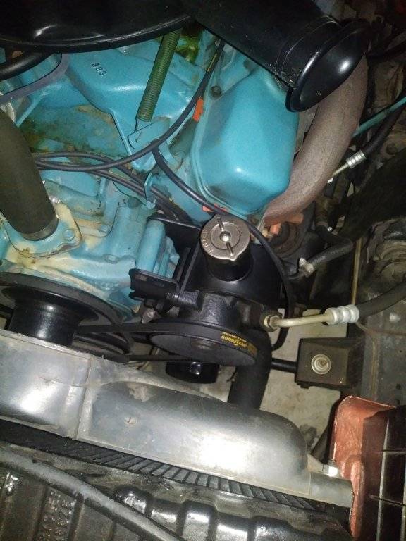

My question for @cbarge, do the aftermarket steering brackets work with A/C
Classic industries show the same bracket but states it's for non A/C cars
However....when I look at @TxDon's A/C conversion, it appears the Bouchillon bracket would work with this P/S bracket.
Any thoughts?
Any thoughts?
Weld up that crack if you like. Do you know how to make thermite? That powder makes an easy weld if you just dab a LITTLE on the spot needing the weld. If you don't know that trick, get a welder or hit the junkyard. I like the old brackets.
