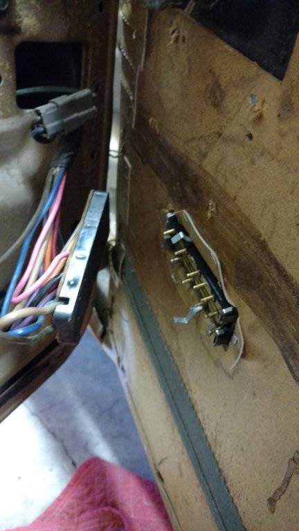

I got lucky. Took the door panel off, first time since it was reupholstered. Fortunately no surprises, was concerned the guy might have jacks something up. I took the back off the switches to expose the pins, the one tarnished pin was to the the shorted switch, hallelujah! Sanded it until it was shiney shot some electronic cleaner reassembled. Works perfectly.
