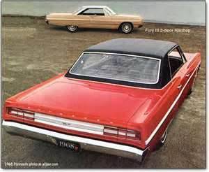

What is the best method to prep and restore the trunk panel. It appears some were finished with red paint to match the tail lights (like mine below), but i'd like to restore it to a bright silver finish if possible. I have zero experience in this area and would appreciate your help.
Thanks Stan. I'm going to order the small everbrite package on their website after reviewing their info/videos. I fear the reddish tone is a result of a faded paint job that will take some extra work to thin and/or sand out.
The paint could possibly rub off with thinner, usually the paint applied to these surfaces is not very durable.
I've cleaned these panels and other bright dipped aluminum and stainless with XXX steel wool soaked with brake or carb cleaner. If the piece is nice enough it will look much better.
Anodizeing is tough to remove, (oven cleaner works), and is expensive to replace. I have powder coated grilles and other bright trim with a clear glossy coating that looked good too.
