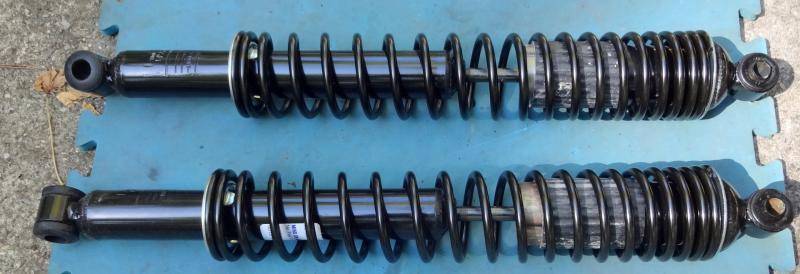

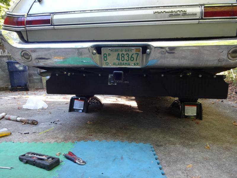

I installed a new set of overload rear shocks today, Monroe sense-trac's. They added a half inch to the rear ride height.

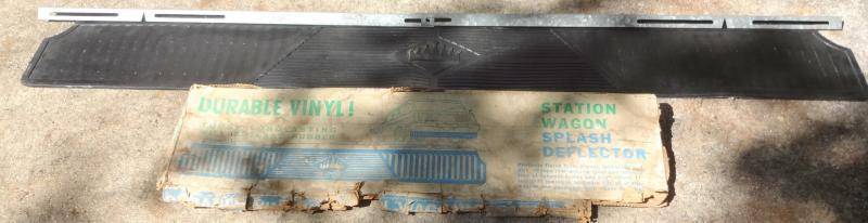

Also the obligatory full width rear splash guard. The shocks were easy, splash guard was a PITA to install.

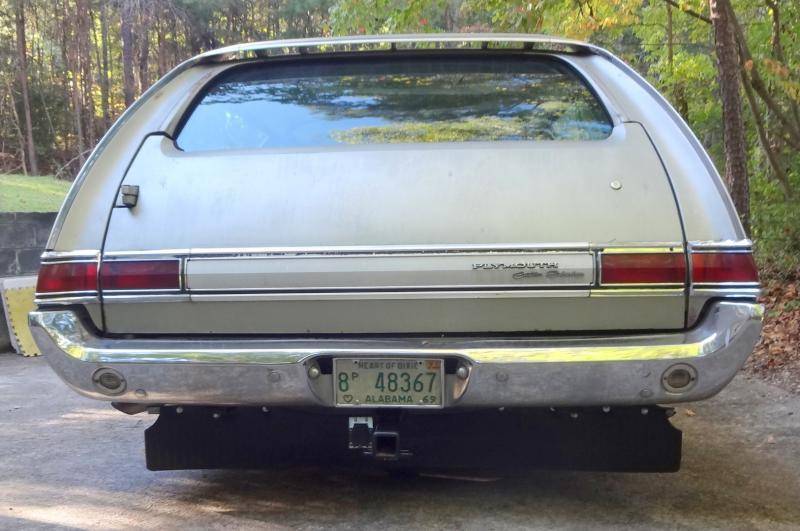

I like the Hitch it looks good, I always kind of wanted a Big Wagon for towing, Hauling, Camping Etc.

These same shocks I put on the '79 New Yorker with the same results. Well worth it and the effort involved. This was three years ago and still are holding up fine.
