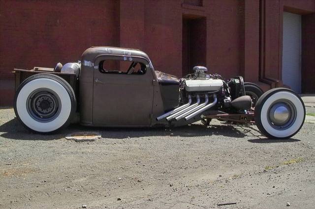

Yea, the 318 probably isn't gonna work for you unless you were doing a Mopar version of E.J. Potter's Widow Maker.
If you are building something like that truck above, a warmed up 318 is more than capable of scaring the $hit out of you.

I think he's building a "bobber" truck.
Truthfully you aren't far off guessing a bobber truck..... Think blown alcohol (ethanol only cuz it's illegal to run methanol on the street) injected 2200lbs (guesstimate) of hatred for hybrids and diesels packaged into a custom built tube chassis with a 1926 ford model t cab on it
