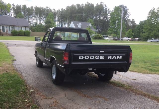

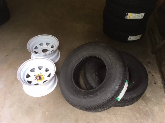

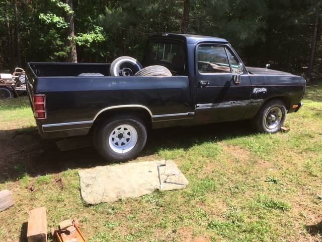

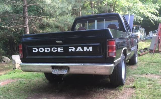

I got the new wheels & tires installed on the rear. (Different bolt pattern after rear end change) Got the brakes bleed & pedal feels very good. Got the rear bumper installed. I think my new driveshaft is too short. Loud clunk comming from trans area when shifting from park to any gear. Did a couple of dry hops in the yard & it clunks very bad. So I slid back under the truck to check & the u joints are tight but I can move the driveshaft around at the front yoke. NOT GOOD. I was worried about the spline engagement. Only have 2 1/2 inches with the 727 yoke. Another 1 1/2 is not splined. So I have 2 options. I can buy a new 6 inch yoke $85 bucks that's splined all the way down. See pic. Or I can take the driveshaft back to the shop that built it & have him make it the correct length. I hate doing that as that shop is an hour away & that's two trips. And it will take him another week. Leaning hard to just getting the new fully splined yoke. And a new u joint installed. Then I should have a full 5 inches of spline engagement. The tires are 29 inches tall on 8 inch rims. Balanced out with very little weight. That tall tire will be nice with the 3.91 gears.
