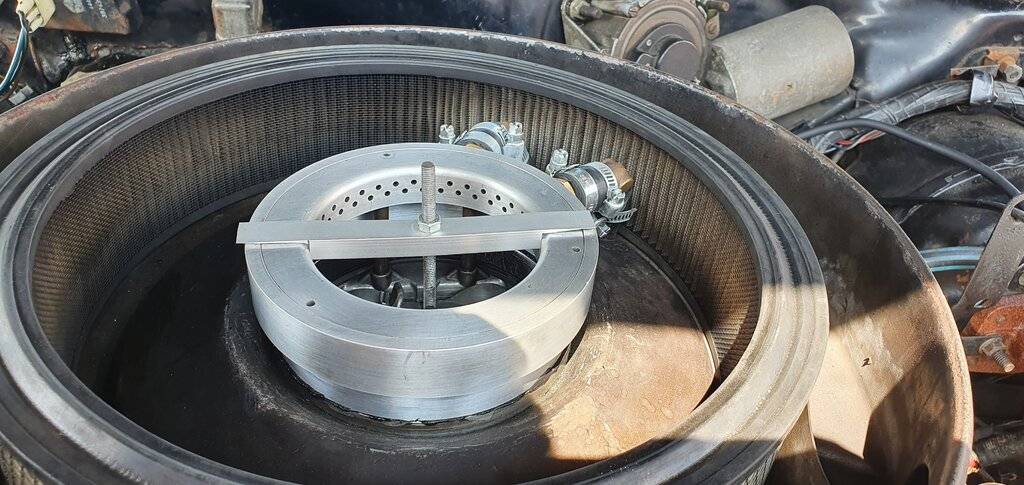

Propane is piped in in this case from the underside of the air-filter-base, so enters from top of the carburator/before the throttle-blades, just like normal air/fuel would.

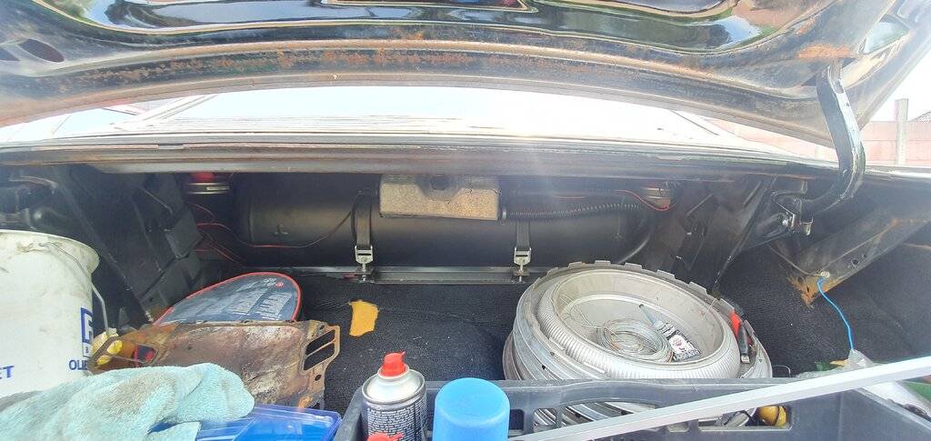

This is how my car ('75 imp 440) is setup, which I think is pretty typical for these cars around here:
Please ignore the mess in the trunk
Behind the rear seat is mounted a 80 liter tank which I think is around 22 gallons? Still leaves plenty of room in my case.
Next to the fuel filler cap I have the lpg fill point, you screw in an attachment that allows for the nozzle to clip onto.

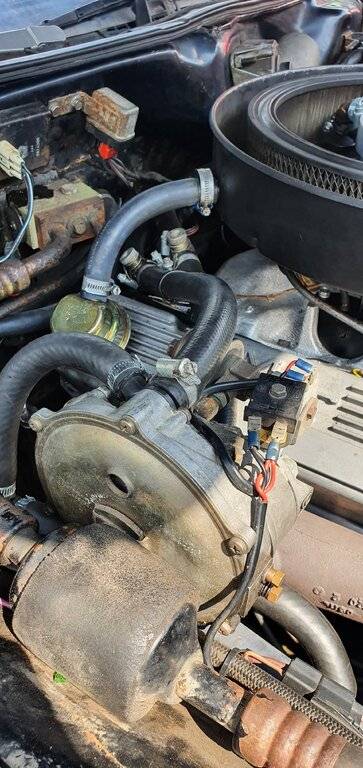

This is my evaporator, it is hooked up to the coolant flow from the heater core to prevent it from freezing up when lpg transitions from liquid to gas. It is an OMVL unit which is Italian I think. In the bottom picture you can see the two set screws in the hoses leading to carb. Those are power valves and have to do with wot.
This is mounted in the air cleaner housing and is where gas is mixed with air. Beneath it is just the regular thermoquad that came with the engine.
