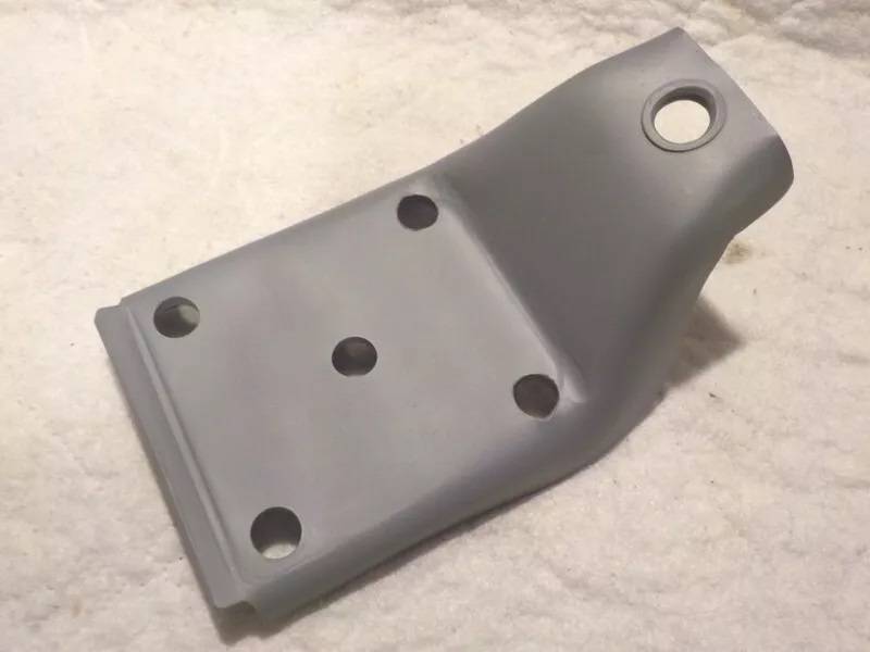

The primary draw back on most sway bars for our cars is the lack of adjustability especially for a modified car such as yours. It would be fairly easy to fabricate an adjustable link to allow for a Zero force at rest. You really don't want any initial preload until you have had a chance to drive it.
I intend to fab spring and chassis mounts and an adjustable link and only use the sway bar. I could purchase the FF bar as their mounts are superior, however I would still need to fab an adjustable link. If I can find a pair of the factory spring mounting plates I can easily replicate FF's kit for less. Finding the correct length/width bar shouldn't be too difficult if you are starting with nothing and the cost should be significantly less. Here is a photo of the factory spring mount you would need.
