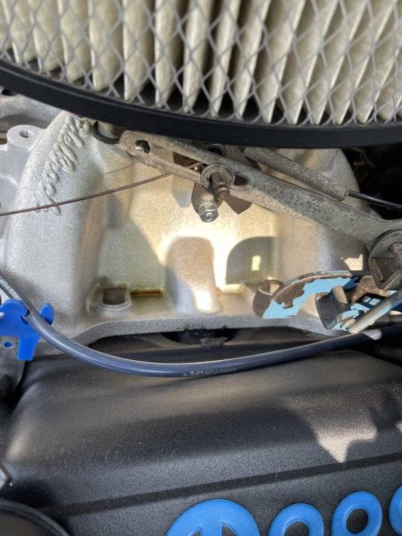

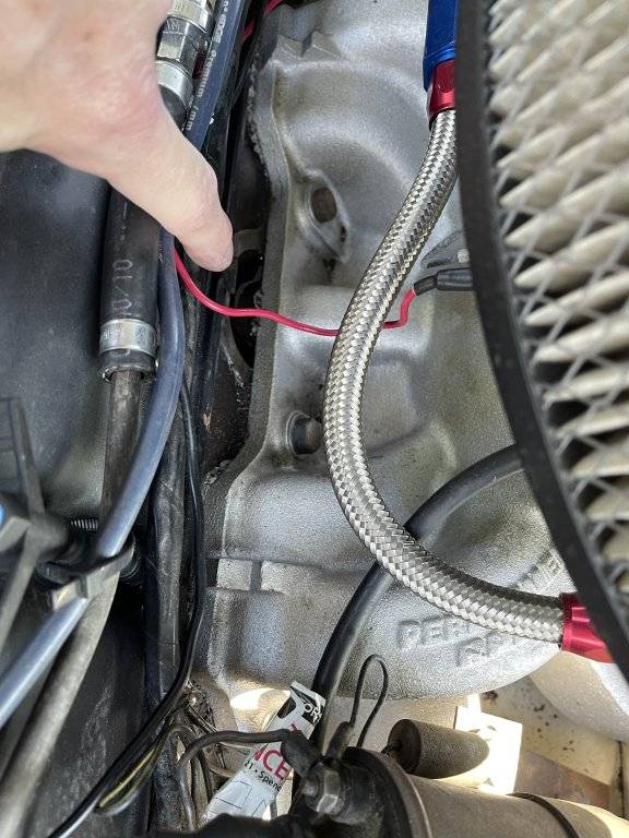

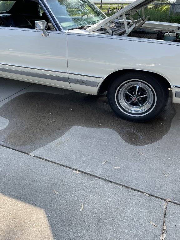

Started my car and backed it out of my garage to let it idle/warm up. I usually pump it twice, start it, put it in reverse and it backs without me having to push on the gas pedal.
It usually idles high so I give it a light tap to kick the idle down. I did all this today and then smelled gas. I turned the car off, popped the hood and this is what I found. Pools of gas on either side of the manifold, mostly on the passenger side. All of this happened in less than three minutes.
I had the intake manifold and carburetor installed last June and have had an occasional pop/backfire if I try to step on the gas too quickly but never any gas leaks. 99% of the time the car has run great.
If any anyone has any suggestions I would appreciate the help. Thanks

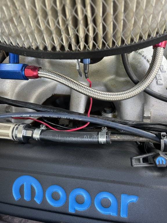

How tight are the fuel line clamps? Is that wetness I see around them? Have the rubber fuel lines a the rear of the stubframe and into and out of the fuel pump been changed, too?
Any fuel in the oil? Might be sure all of the fuel in the heat crossover part of the cyl head has fully evaporated.
Which carb?
Just some thoughts,

Are your rubber fuel lines fuel injection rated? If not, I recommend switching over as today’s gasoline will eat away at the standard rubber fuel line hose.
What carb are you running? I don't like the looks of that transmission linkage adjustment either. Just sayin.
Holley 750 and yes the transmission linkage is going to be dealt with this summer.
I would inspect your Holley closely. There are a lot of places where they can leak gas. You did mention backfires. The power valves can blow out and cause rich running as well. The transmission kickdown can cause transmission failure in short order if not adjusted properly.

Turns out the fuel filter had come partially unscrewed. Tightened the filter and the hose clamps at each end, problem solved.
And with all the responses I got I now have about a dozen other things I know to check next time. The people on this website are one of the best parts of owning a C-body.

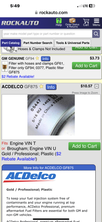

You need to toss that junk filter over your shoulder and replace it with something that doesn't unscrew or crack.
