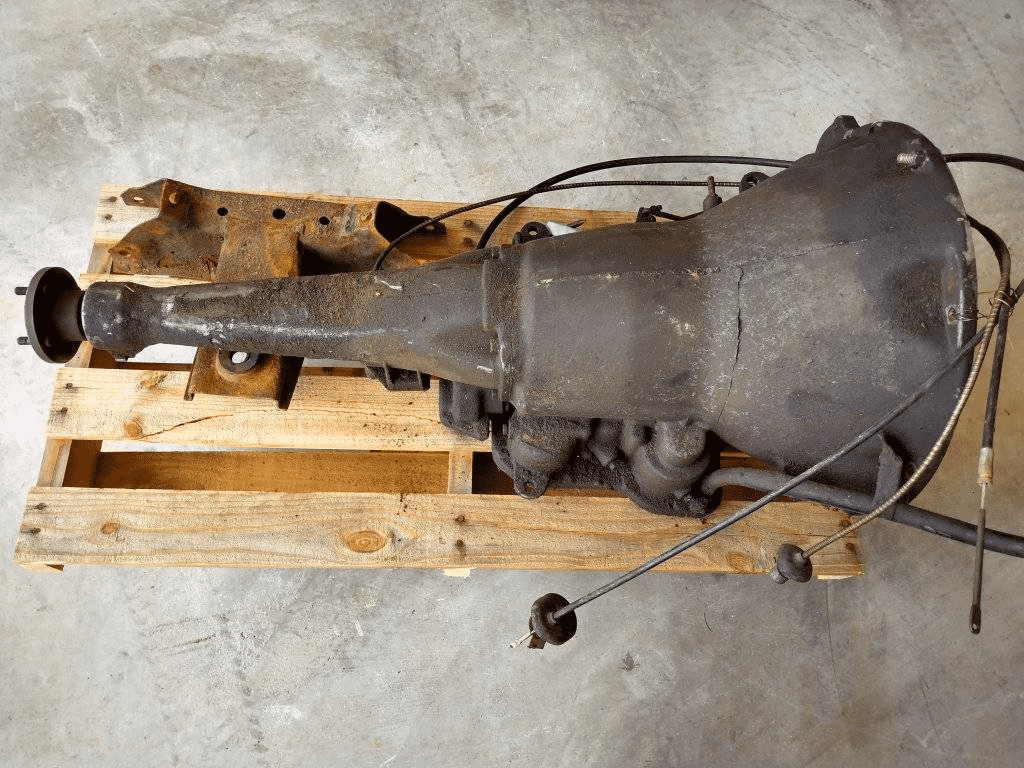

I recently removed the 440 and a727 from my '68 as a single unit. As others mentioned I removed the rad and all the accessories first. I forgot to remove the transmission crossmember which made it a little more difficult but it still wasn't terrible. This was by my lonesome using a 2 ton engine hoist as the smaller 1 ton hoist wouldn't reach far enough without removing the front rad support which I didn't want to do.
First time doing this and it was easier than I anticipated. My wife helped with dropping them back in together and that also wasn't terrible but that did require me to remove the trans crossmember which should have been done before removal.

I did not remove the transmission cross member in my '68 and I should have as it definitely made it a little tougher to remove the engine and trans. It also caused the trans tail seal to get caught and rip in half.
I removed the cross member before reinstall and wish I did it before removal.
Not sure of your model year but I would guess removing it is a better option and really not that difficult.
