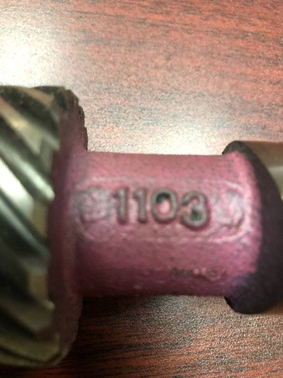

Hey All,
I recently got a really decent deal on a Purple cam - according to the guy I bought it from, it's part # P5007 697
It has these numbers on the shank:
I think it says 1103

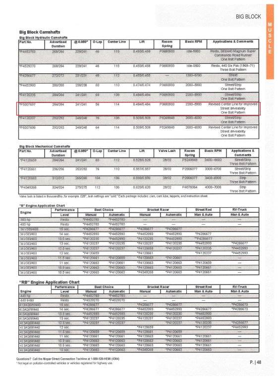

I've been able to find out that this cam apparently has the following specs, but I could be wrong. Can anyone please confirm:
Intake Duration @ 050 Inch Lift 241
Exhaust Duration @ 050 Inch Lift 241
Advertised Intake Duration 284
Advertised Exhaust Duration 284
Intake Valve Lift with factory rocker ratio 0.484”
Lobe Separation in degrees 114
What I CANNOT find out for the life of me is whether or not this is a cam that would be good for a 440 in a heavy C body with an automatic - will it have good low end torque? I want to use it in a near stock configuration - 516 heads, factory intake, dual exhaust through factory manifolds. I don't need a high winder, but rather something that idle decently, and will be a stump puller off the line - fry the tires putting my foot in it at the stoplight... I want torque...

It can work . . . but would probably need at least 3.73 gears to meet its potential. On a 440HP, with 3.91 gears, Holley 3310, Edelbrock 4bbl intake, 4-speed, and headers in a '69 B-body, it can basically equal Street HEMI performance. It is good that it has the 114 degree lobe separation, though.
Being a P5________ part number, this indicates that it is one of the later versions of the orig cam? I have one of the orig versions. I put in my 440 block to check the lift and duration. I was a bir shocked at what it had in comparison to a Comp 268HE for a Chry B/RB engine. From what I discovered that fateful evening in my shadetree shop was that the Comp 268HE probably had more "area under the curve" due to the fact that max valve lift was attained for 10 degrees of crank rotation, plus the "quick open, slow close" lobe shape. The P3690___ Purple Shaft Street HEMI cam held max lift for ONE degree of crank rotation.
To get what you state you desire, it might need a 500cid stroker to tame that cam down to "better terms" due to the larger engine CID. That Summit/repackaged Lunati "modern HP" cam might be a better deal for your desires?
Do not be specifically "blinded by the Purple Shaft glow". Compared to what used to be the real "Purple Shaft" cams, MP took that name and applied it to many other cams. Obvioiusly for the marketing affect it would have. Splash a little purple paint on it and it's all good, somebody probably felt. Most of those cams had 110 degree lobe separation angle, as I recall.

The 484 is a bit rowdy for what it is. I have it in my charger with the stick. Definitely not a cam I would use for what you described.
I have one in my smog 440/727 but I have a higher stall converter, tti headers and 3" pipes, 3.55 275/60/14. It starts pulling hard at 2500. I'm sure my combo is terrible, but I had the parts.
The MP484 used to be 108 LSA and it might tend to be a bit of a dog on bottom end given your application if it turns out yours isn't in fact 114 LSA.
You could probably get away with a 3.23 and a Hemi type 2400ish converter but a stock converter and a 2.76 will get real old real quick around town and it won't be happy on the freeway at kinda legal speeds either with a 2.76. Click 2 and step into it at 65 and it will put a smile on your face tho...
Tire roasting at will is going to take some gear and at least a 3000 stall converter that will flash closer to 4K.
I have an MP509 in my 493 and because it has 53 extra cubes it made good torque from off idle and would hurl 4800 lbs of New Yorker through an intersection with authority even with a stock converter and 2.76 gears but it was a complete pain on surface streets because it idled at 1100 and with the 2.76 gear you were riding the brakes to keep it under 25 mph never mind the smash every time you went from P to D or R. I changed the rear to 3.23 and installed a Turbo Action 2800 converter and it was 100% better.

It won’t do what you want. It is a higher rpm cam, needs a converter and gears to work good, and the idle is choppy. Not for a stock engine.
I love the idle, perfect lope and sounds awesome. I agree with everything else, though, better cams for what Ross wants, modern grinds can get the performance without sacrificing driveability.
Have an old (~1999) .484 purple shaft in the convertibles stock 2bbl 383 with a 4bbl swap & HP manifolds. Its not terrible as a cruiser but by no means a speed racer. Swapping from 2.76 to 3.23s made a world of difference with it though. Need to swap out the factory 11" converter to reallly wake it up.
Sounds fantastic though lol & would consider putting the same cam in my SFGTs 440 if I stubble upon an old unused cam/lifter kit for a resonable price. But as others have said, there are much better grinds out there today then compared to 20 years ago.

Update - re my question about an RV grind: Elgin's catalogue puts the above linked camshaft in their RV class:
Now you've gone to the too small side :p
In my experience, even old school grinds like a comp 268h or 270h behave like you want in a 383, so you could go up a step from there.
If your putting it in a 2 bbl 383 (low compression) that 284/.484 has too much overlap to work with that low compression. I have one in my(8.43:1) 400 in my Challenger, has no low rpm response, and it's a lighter car with a converter and 3.23.

Hey All,
View attachment 544310 I think it says 1103
