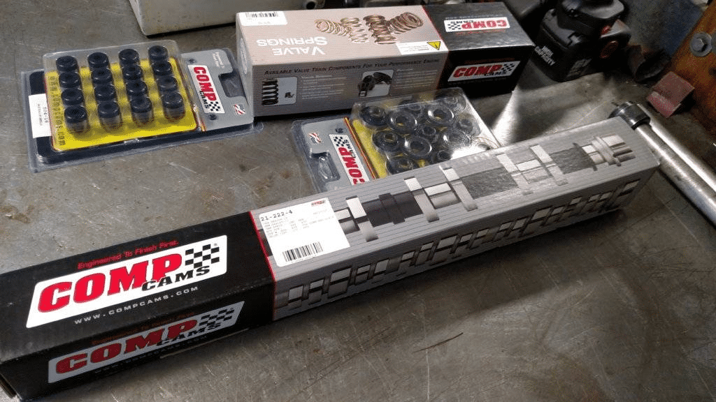

Ross:
Here is the cam I'm using in my '66 300 convertible (No. 21-222-4). It is advertised by Comp to work well with 3.23 gears and provides good vacuum. It has worked out well for me - has excellent throttle response and I too am running 516 heads:
Also known as the Extreme Energy XE262H. I believe that is one size smaller than the XE268H I am running in my 451 stroker.

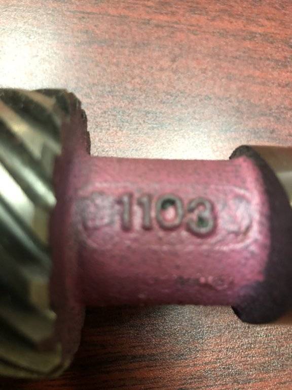

Hey All,
I recently got a really decent deal on a Purple cam - according to the guy I bought it from, it's part # P5007 697
It has these numbers on the shank:
View attachment 544310 I think it says 1103
I've been able to find out that this cam apparently has the following specs, but I could be wrong. Can anyone please confirm:
Intake Duration @ 050 Inch Lift 241
Exhaust Duration @ 050 Inch Lift 241
Advertised Intake Duration 284
Advertised Exhaust Duration 284
Intake Valve Lift with factory rocker ratio 0.484”
Lobe Separation in degrees 114
What I CANNOT find out for the life of me is whether or not this is a cam that would be good for a 440 in a heavy C body with an automatic - will it have good low end torque? I want to use it in a near stock configuration - 516 heads, factory intake, dual exhaust through factory manifolds. I don't need a high winder, but rather something that idle decently, and will be a stump puller off the line - fry the tires putting my foot in it at the stoplight... I want torque...
Thanks all!
Revised centerline for improved street drivability. Specs you have are for verbatim out of the Mopar Performance Catalog.
