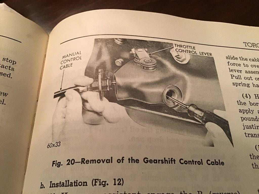

1962-1965 727 were cable shift. The cable goes inside the trans. First photo is a cast iron from 1960. 1962-1965 727 same idea.

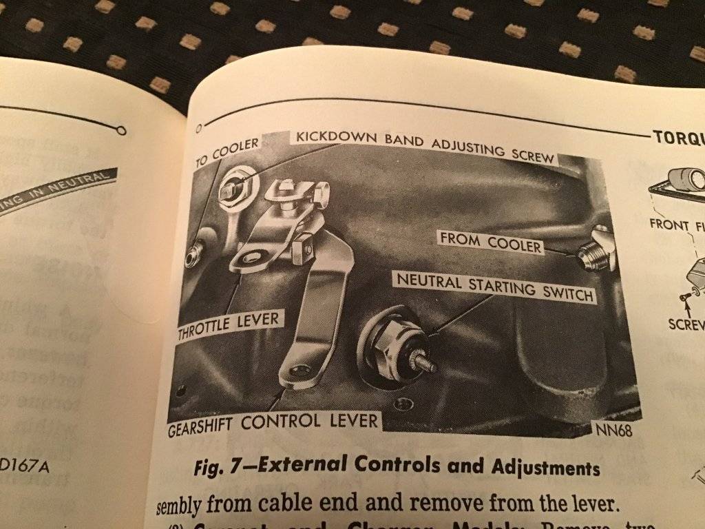

1966 and newer 727 is linkage shift. A shaft comes out of the valve body through the case. Levers bolt to these shafts to shift and for the throttle pressure linkage. Second photo.
Sorry what year is the 440 and 727? Are you talking about a 727 lever transmission (1966 and after) or a 727 cable shift (1965 and before)
thank you that explains it - my 727 is a later model with levers
