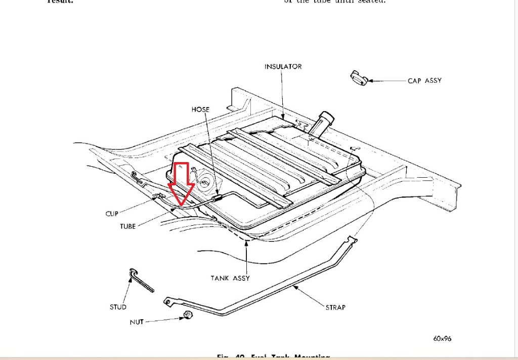

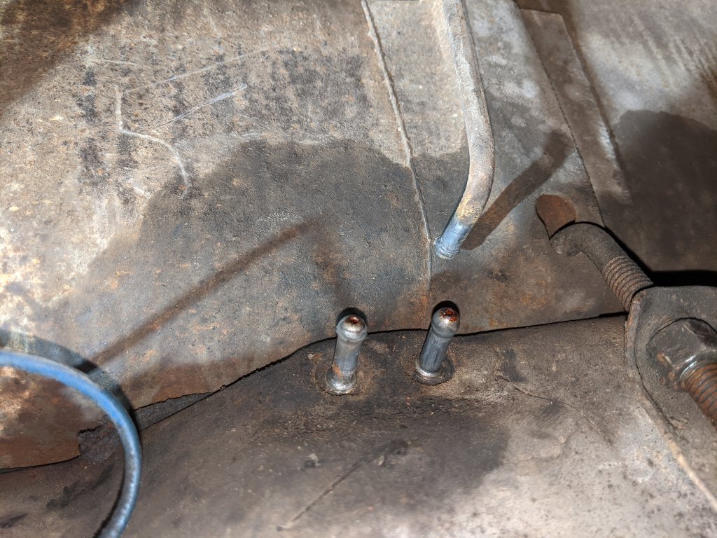

Hi folks. New to the forum. Here’s the scoop: 1961 Chrysler Newport. 361 automatic. Spent the day wrestling with rusty nuts and bolts but got the old fuel tank out and the new one in. After hooking up the fuel return line on the new tank I began to trace it forward towards the engine and lo and behold it just stops and points down almost like a vent. My question is- is this a hack from a previous owner is there really no return line? The carb is. A 2 barrel stromberg WWC. I would have looked further on the carb for the mysterious return but got lazy and decided to “research this further”. Anyone have any thoughts?

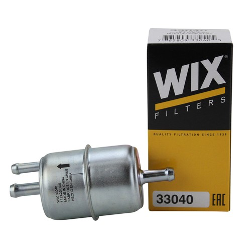

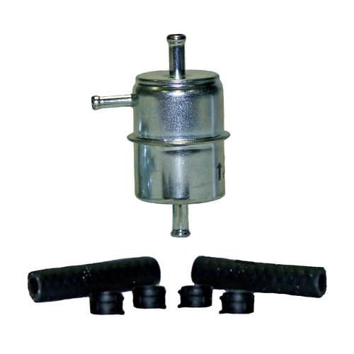

Hello. There is no return line from the carb. If you would like to add a return line you can use a fuel filter designed for the 76 Chrysler v8s, it has a small metered return nipple. WIX 33040 WIX 33054.
