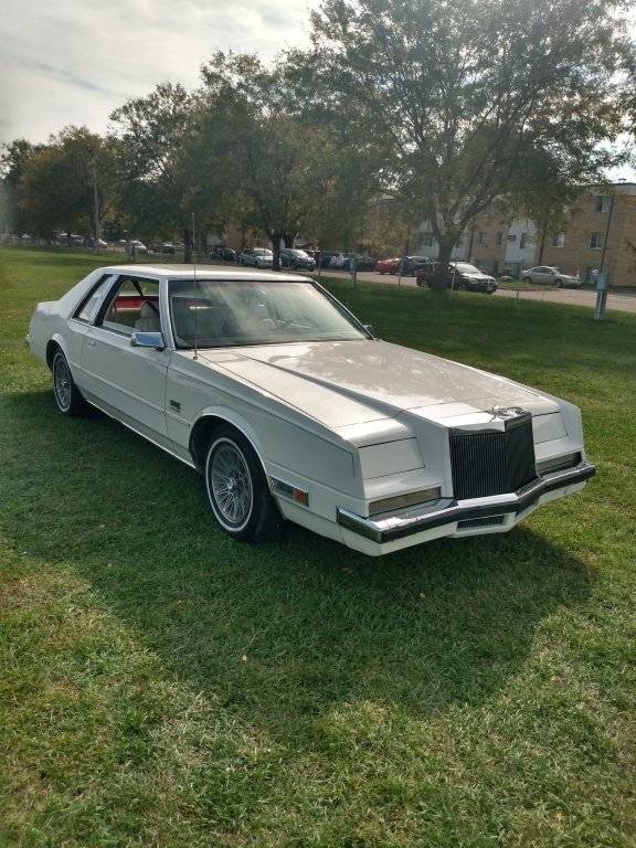

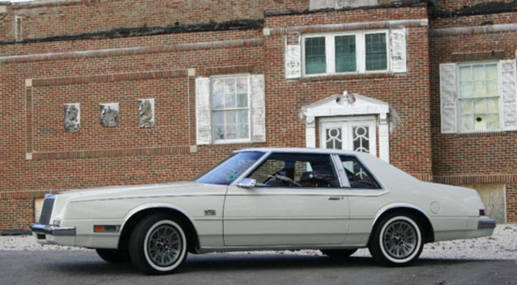

U actually considered parting the car out and buying a 83 imperial I know of, keeping the wheels, tires, and motor, and swapping the 400 into it.
The body is good and the paint is good about the same or better condition as my newport, the guy wants $800 for the whole car. It ran 3 years ago but I dont trust a 318 EFI.
That Imperial looks like a twin to my factory carb converted 81.
