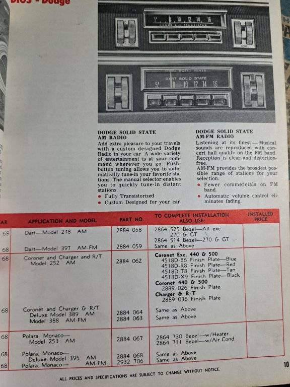

68 factree Chryco CANADA parts Catalogue does list the 2649 965 for C body Dodge only.
The AMERICAN 1968 Accessories Parts Manager's Catalogue
Shows 2 different AM radios..
Model 253, # 2884 067
Deluxe Model 395, # 2884 068
Ok.
68 factree Chryco Canada parts Catalogue does list the 2649 965 for C body Dodge only.
The 1968 Accessories Parts Manager's Catalogue

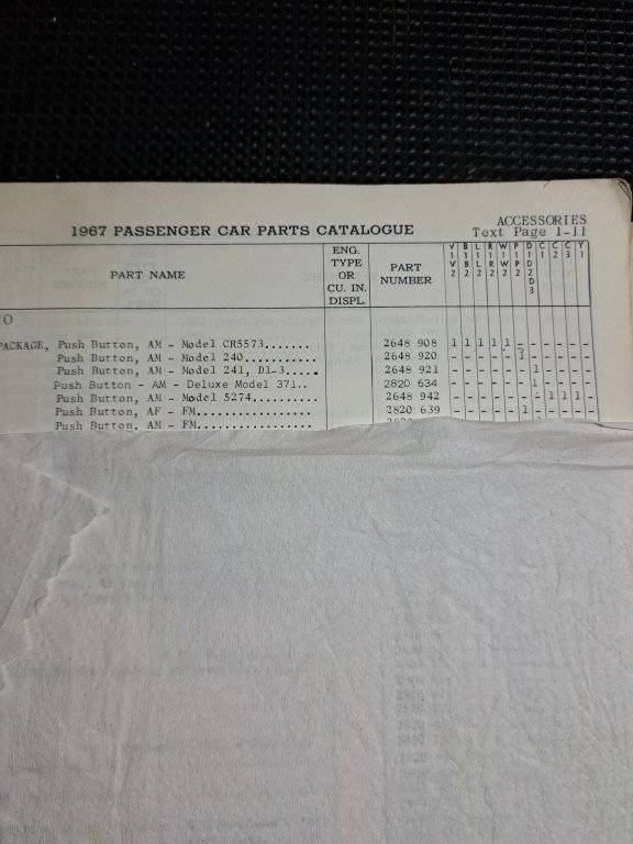

My 67 Chryco CANADA Parts catalogue shows different
part numbers for the radios altogether!
Basic model 241, # 2648 921
Deluxe Model 371, # 2820 634
SO....in theory the radios from factory are different compared to the units for the parts counter beans.
I do not have U.S. parts catalogues to compare if there are any differences.
Anybody feel free to chime in if they are the same or different.
Also even after 2 years of the AutoPact, Chrysler Canada (or Chryco Parts) still had to use Canadian suppliers.
An example of this is 1966 Canadian built Chrysler's used different radios compared to American built Chryslers.

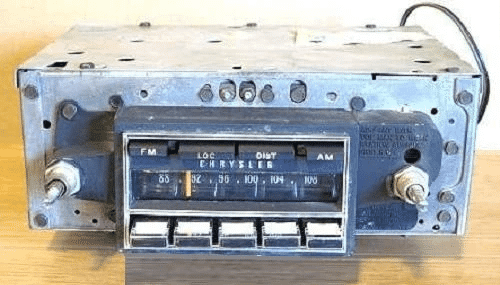

The Signal Seeking radio in my '70 300 also has "local and distant" switches. I have no idea if that makes a difference now that it has the Aurora conversion.
That's the radio I have with the seek floor switch. I'm in the process of finishing up the dash, but one of the transformer coils is missing from the back, so it's "in-op". What is this Aurora conversion you speak of? I've been looking for a working original to the tune of $400 (pun intended), but perhaps better money spent on a conversion? For the record, I never listen to the radio in the car even on long trips, but would like to at least have something operational to get local weather and traffic reports.
The Aurora conversion is pretty cool. Basically they gut the radio and put in new stuff. I've had it done with my 300 and my Barracuda. Aurora FMR Stereo Conversion
If it's $400 for a used one, doing the conversion is a no-brainer.
