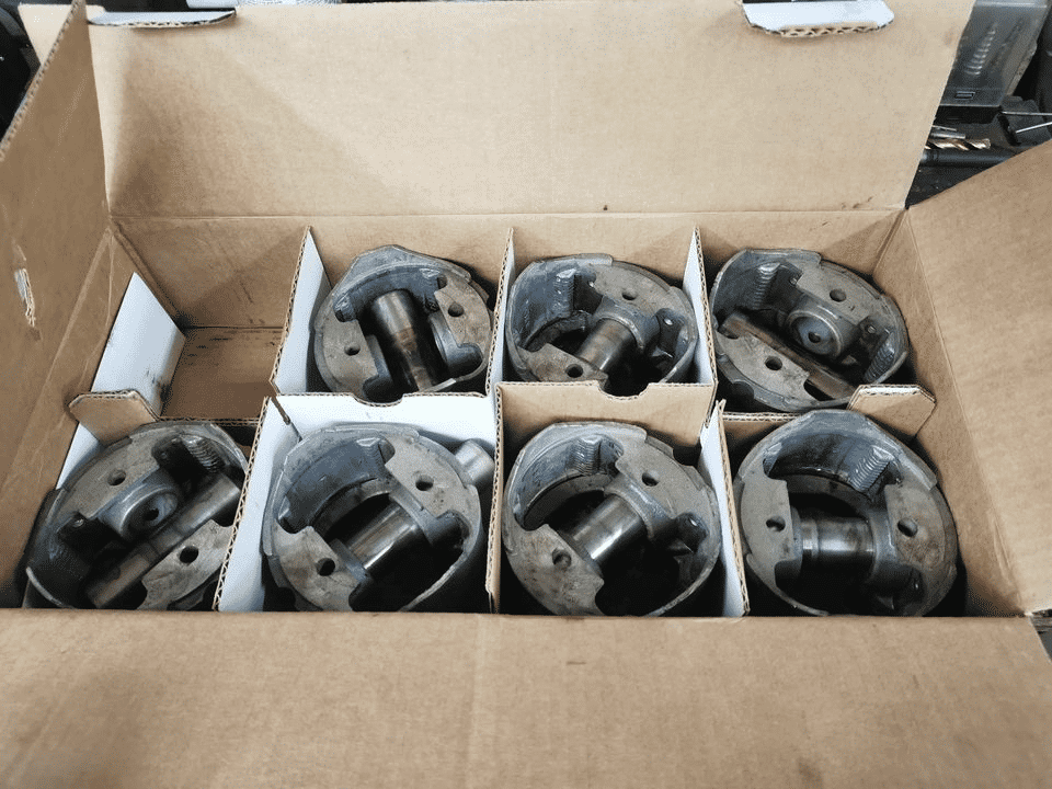

Hi everyone,
I have a 1966 issue 440 for which I will require replacement pistons. I am going to sleeve the block back to original bore. I will be using reconditioned 516 heads as they are what came on the engine originally.
I have a chance to buy a set of used original factory 440 pistons out of a 1973 440. All in good shape (I trust the seller, he's a member here and a personal friend).
The question is about the compression ratio - the original compression ratio of the 66 440 was 10.5:1, and if I recall correctly, the pistons sat just a tad in the hole. I need to know if the 73 440 pistons will be the same compression ratio, and if they'll be suitable to retain the original compression ratio.
Thanks in advance!

Thanks everybody for your responses. I understand that advertised compression ratios and what the compression ratio actually is are two different things. Regardless, I do not want to increase the compression ratio, and I am just performing a stock rebuild.
These used pistons are flat tops. I fully expect that the compression ratio would be less with these Pistons then what would have been used originally in mine.
How much so is what I want to find out.
If it's going to be a drastic drop in compression then I'll pass on them. If it's only going to be a point or half a point (regardless of advertised compression ratios and actual compression ratios), then I would like to buy them and deal with maintaining the best-case scenario with head gaskets.
The engine was so seized up that I had to break the pistons apart that were in there, and so I don't have any to compare. I will be sleeving the block to go back to factory bore.
If anybody can tell me what the advertised compression ratio was for a 1973 440, and whether the pistons sat above the deck (due to the use of different heads than the 516s I intend to use), or in the hole - that's all I really need to know.
If CBODY67 is correct and the 73 pistons are .125" in the hole (I suspect he is correct but I could not find that data in the FSM), my calculation is that you would be in the 9.2:1 range with 516 heads and a 0.020 head gasket. To me that is purty close to where you want to be on a stock motor with today's fuel. The 73 440 rated compression is 8.2:1. You also can shave the heads to get the compression up some or use a thicker gasket, or deck the block some........
But everything would need to be measured to verify actual compression..........
If you get the compression height of the 73 pistons, measure top of pin to top of piston and bottom of pin to top of piston, add, then divide by 2. Compare to old pistons (listed compression height). Use online compression calculators and you will get a idea of amount of compression drop you are going to experience.
If you have the old pistons out you can measure them and compare.
