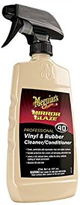

I personally wouldn't put the wax on there, this is what I use it's designed for it holds up pretty well.
I have used both the meguiar's and 303 products and I recommend both.
We are all on the same page here, actually I forgot about the 303 I think a like it better. Just started using it a couple years ago had used the Meguiars product for years before that.
