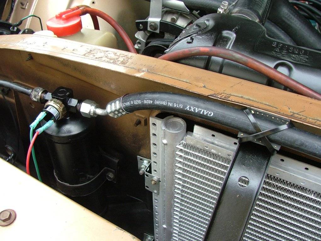

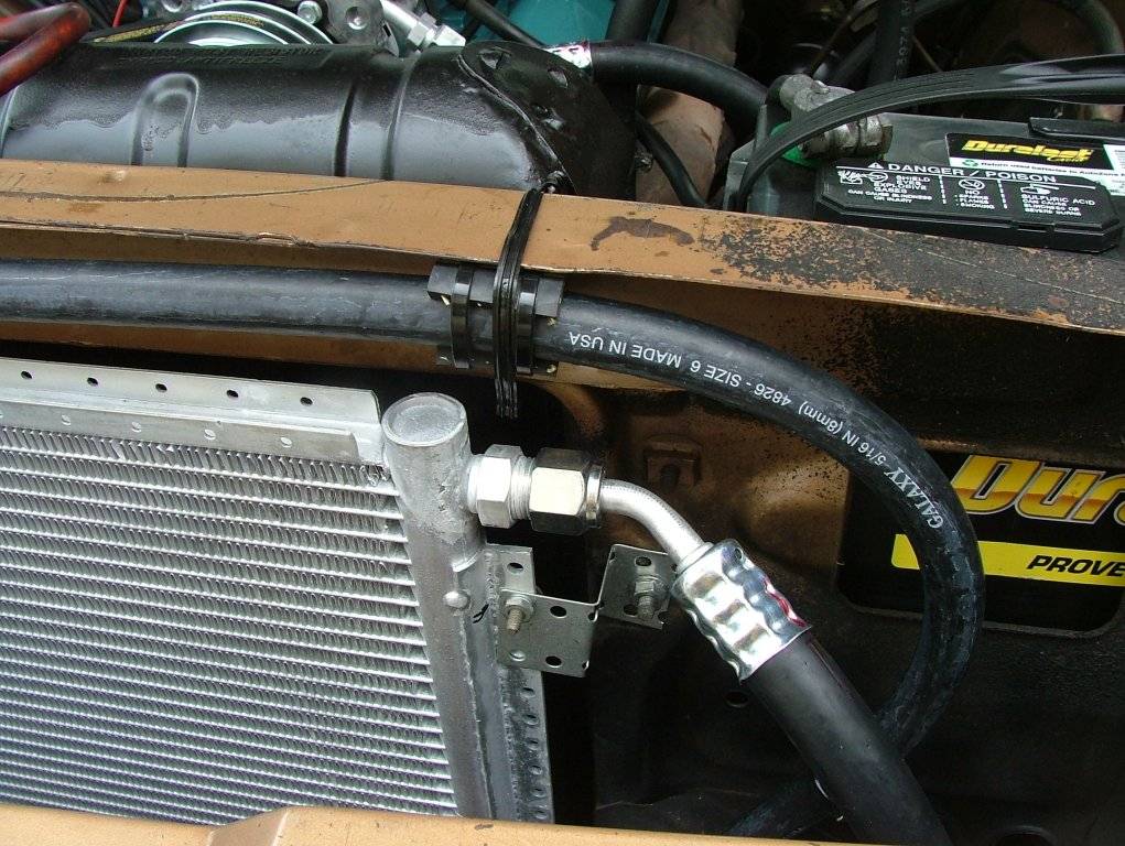

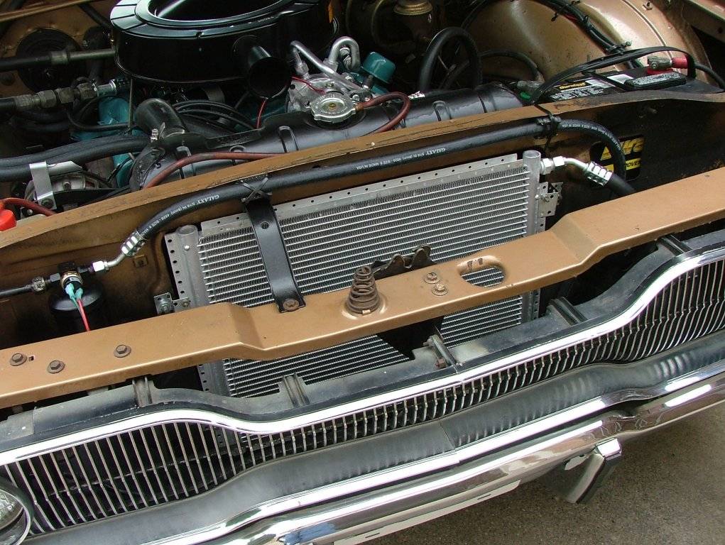

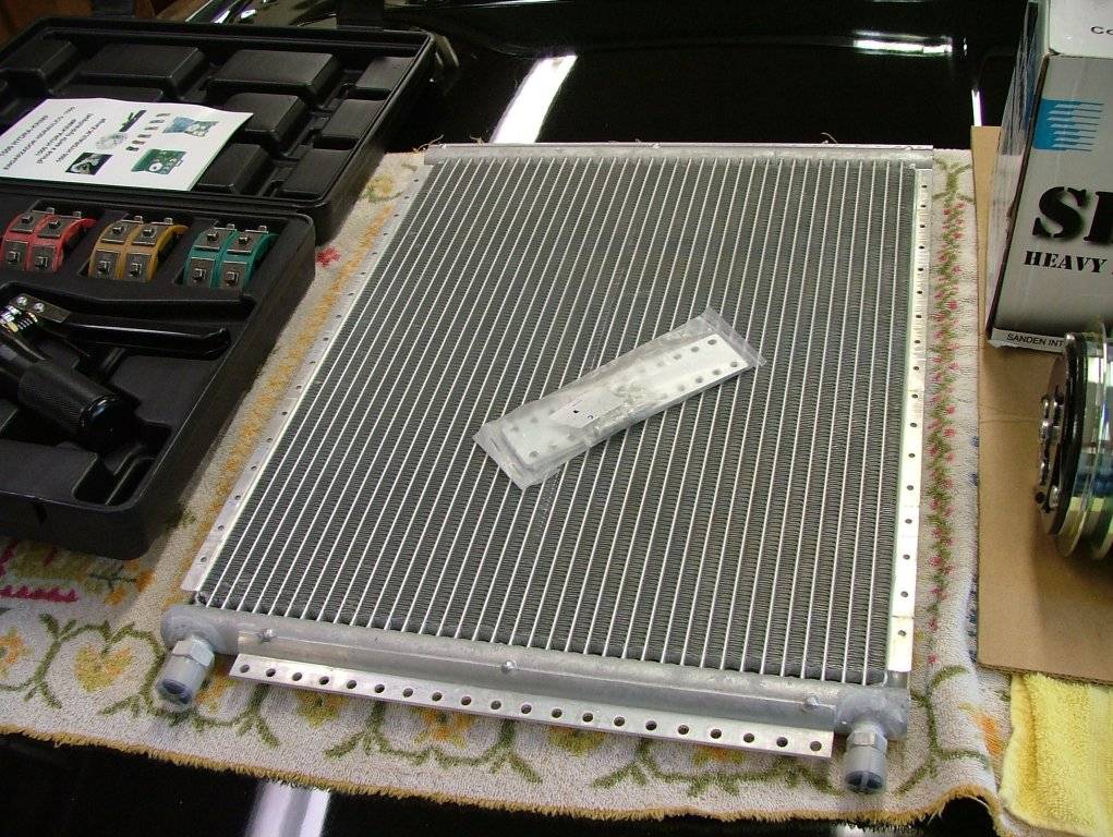

I used a 20 by 16 unit from Nostalgic AC Parts # 54-1620 on my 66 Monaco
