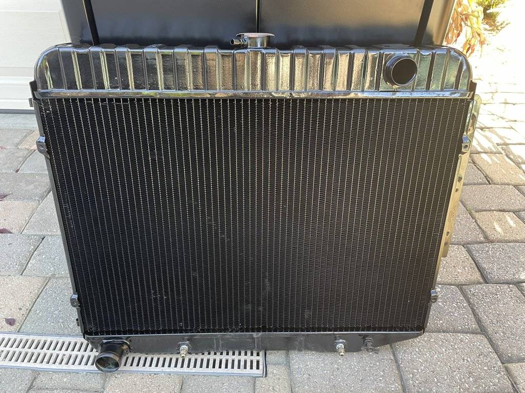

For closure....
it came out very nice.
the new core has a lot more tubes than the original one, should be more efficient.

For closure....
Ah, a High Efficiency core! My '83 Dodge D150 has one. Just 2 rows, but w H.E. spacing. Does OK in town, but when on these DUSTY, BUG INFESTED, OVERGROWN AZ rural back roads, I have to spray the detritus out of the thing after 1 trip. All the same, YOUR beautiful radiator should shed the heat very well!

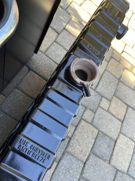

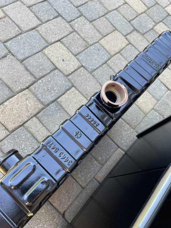

Anyone wise to the location of date codes on a sea-body radiator?
I see the p/n on my top tank and then another number "20446" - unsure if this is a date code or not.....
EDIT: also this on the side rail... 3040 = 304th day of 1970? = Halloween, 1970.
