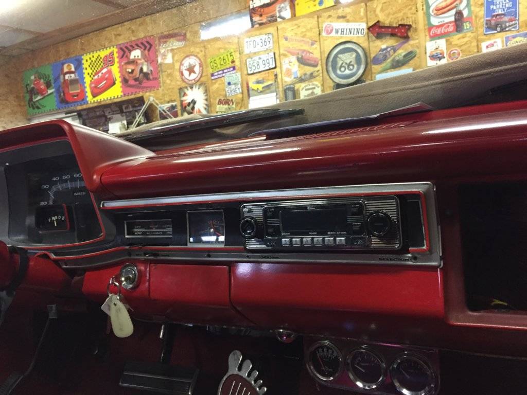

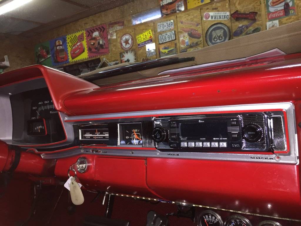

I installed a Retrosound Redondo and I'm very pleased with it. I can't remember what I paid, but I got it from Amazon at well below list price. I'm using my factory bezel and knobs, so it looks 100% factory until it's turned on, which was a personal requirement.
