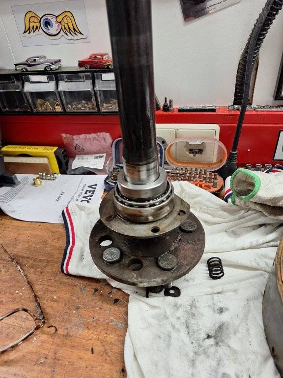

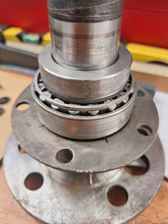

See the picture for the bearing. I had no idea what before hand. Looks factory?
