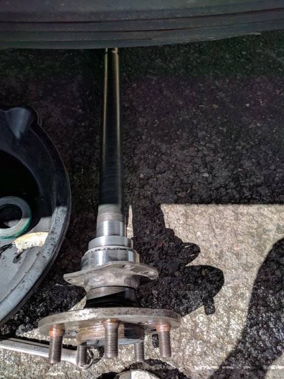

So I just got done with replacing the inner seal. Not too bad of a job except i didnt have the right size round object to hammer it in, so i messed up the metal a little. Probably gonna get a seal installer and redo. I had wearmarks on the axle shaft from the old seal and the old one was rock hard, polished the axle shaft and repacked the bearing and put it back together.
Can someone post a picture of the 8 3/4 housing with the axleshaft removed so i can have a good look on the surfaces? That axle came out waaaay too easy and i suspected the race was spinning but there are no marks indicating such thing on the bearing race!?
