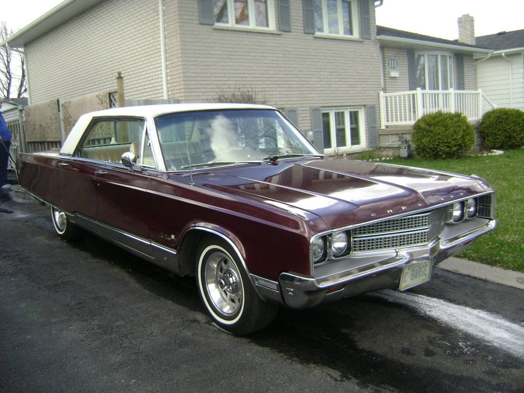

To be honest,my old 68 NYer 440 got 16.25 highway doing runs to Joisey to visit Steve Hobby average speed 62 65 MPH.
It had a 260/260 Purple shaft cam,23570R15 tires and 3.23 Sure-Grips.TTi exhaust and Pertronix ignition inside a recurved distributor,750 Carter marine carb.
