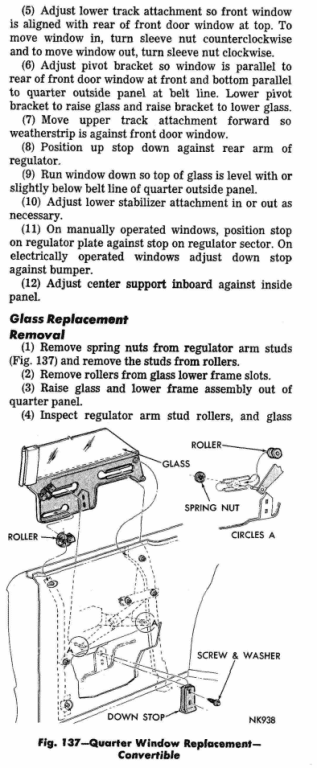

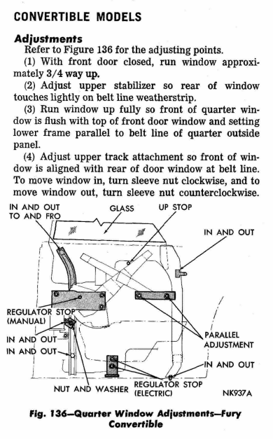

Both rear quarter windows on my 67 Sport Fury need to be adjusted. neither one goes all the way up and do not touch the front window. I have the service manual but an trying to make sense of it. All I can see are adjustments for in and out not up. I think I need to adjust the up stop but The procedure doesn't cover it. Now after reading it I see in step 8 i the adjstment Any hints I think the previous owner just slapped the windows in or rather the restoration shop. If you could call them that. I bought it from a 92 year old but then found out that he had had it in a restoration shop for ten years and I don't think they did anything. other than collect parts that were in the trunk.
