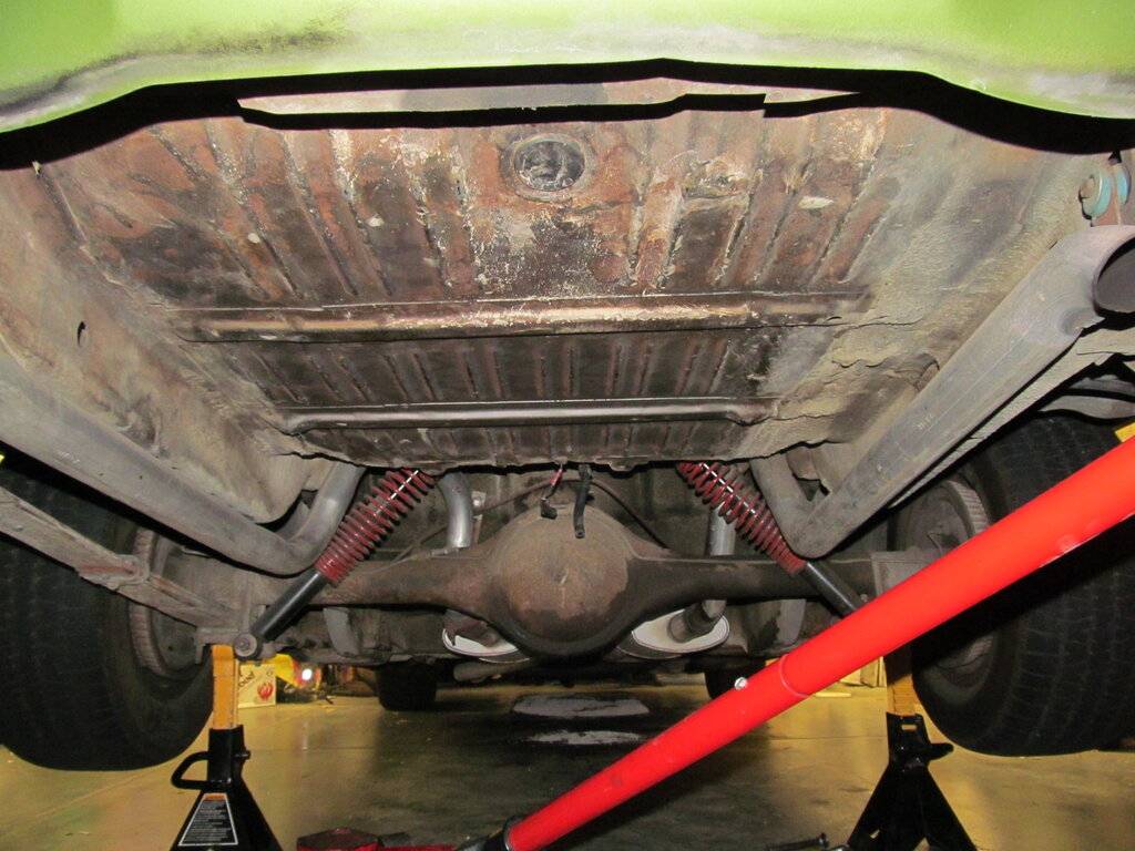

With KG5512, 215-75R15 on 15x7 cop rims would not fit between Quarter panel at top of wheel well and brake drum/lugs. I had to disconnect lower mount of the shock to mount my tires. Returned KG5512 to RA.
