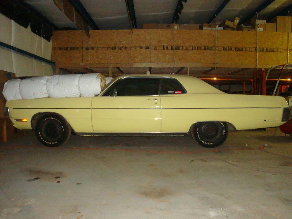

I see that my Fury has a different rear window than another one here in Holland.
His is a Sport, is that why?
PH23 vs PH29

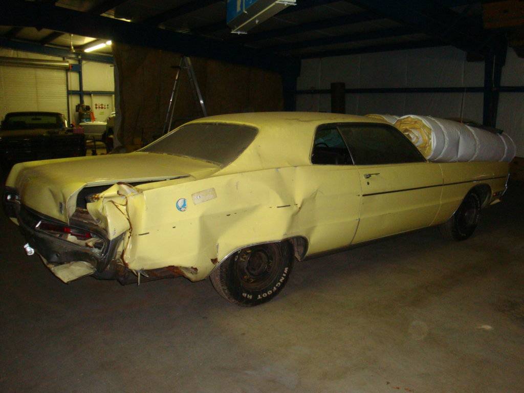

Also, quarter window is different. I have a set of 1970 29 body, tinted quarters and rear window. Would basically give them away if anyone wants them, exception being if I have to transport them somewhere. Then you'll pay for my gas and time.
BTW, both 23 and 29 were available as Sport Fury.
My 69 PH23 Sport Fury
A parts car PH29 Sport Fury I got a lot of parts from.

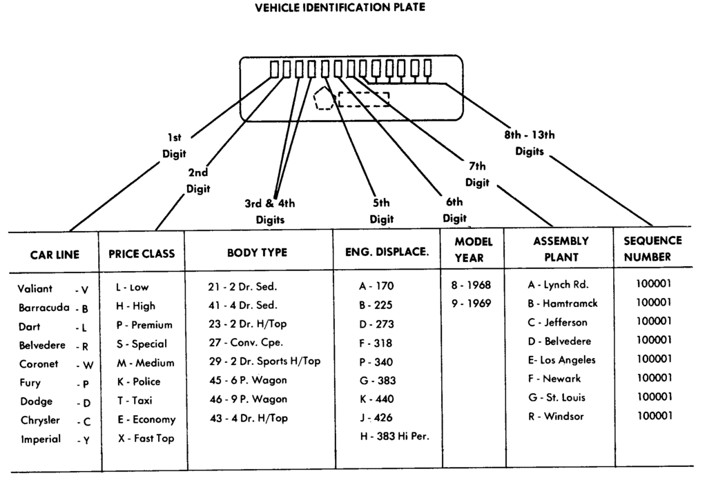

PH is the first two digits of the VIN number. PH23 is a Plymouth two door hardtop, PH29 is a two door formal hard top. Dodge models will start with a D, Chrysler models with a C. For reference down load the VIN number and fender tag decoder at www.mymopar.com. It is a free down load. G11 is the option for tinted glass all, meaning all the glass is tinted.

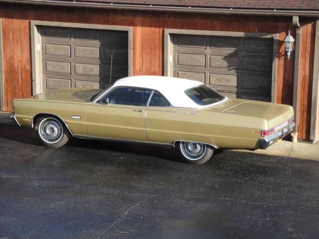

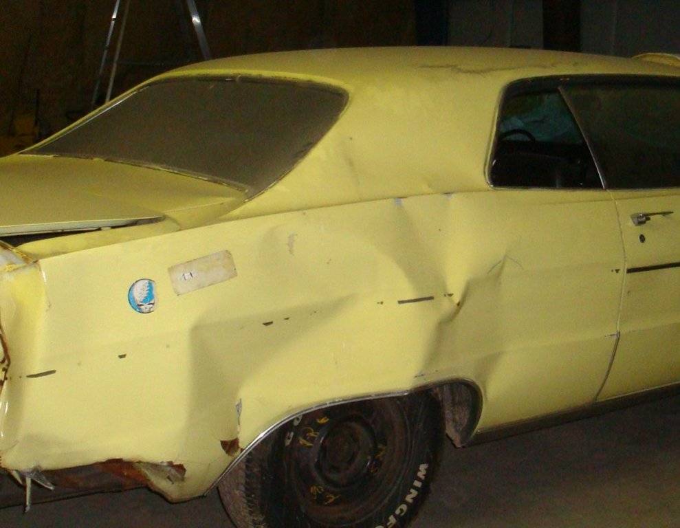

Inquiring minds want to know, did you take off the vinyl or is that stock?
Dave
Best I can tell is that it's stock. No signs of cracked plastic hiding trim holes on the right side from the accident. Of course the fender tag would tell all, but there's too much stuff piled on the hood to open it right now.

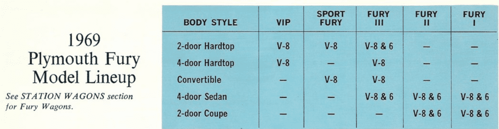

PH 23 or PH 29.
My VIN however starts with PM29, which stands for Plymouth Medium 2 door sports hardtop, I understand.
What does the H (PH) mean.

1970 Fury III parts car. (PM29) There is no fender tag to verify, but there is no evidence of a vinyl roof.

Your car must be a Fury III, correct?
Fury I = PE
Fury II = PL
Fury III = PM
Sport Fury = PH
VIP = PP
BTW, I believe in 71 or 72 the Fury II became PM because the VIP was dropped in 70 so they bumped the 2nd digit and dropped the Economy PE.
