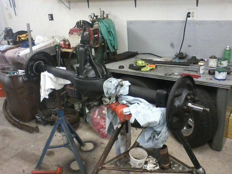

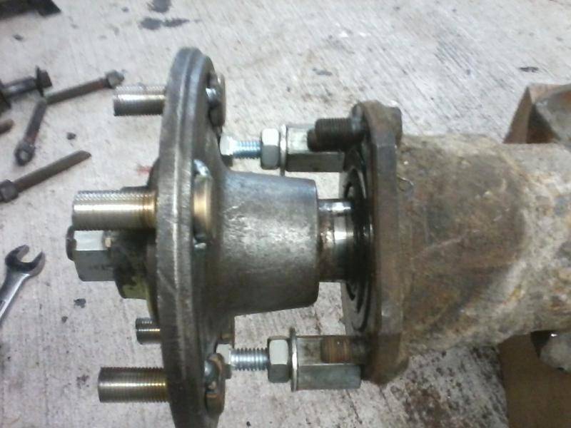

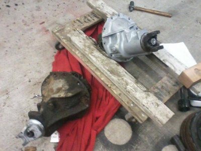

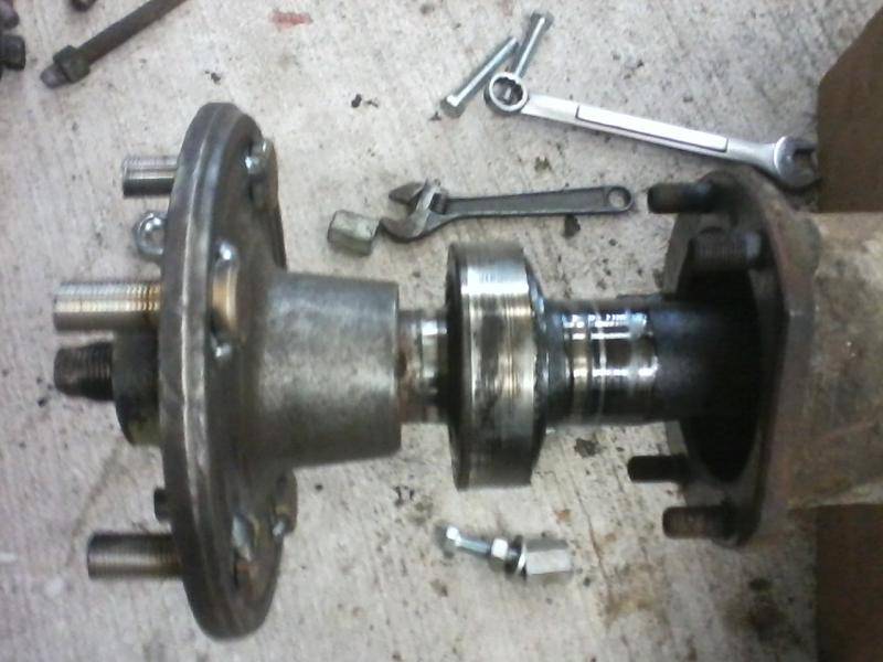

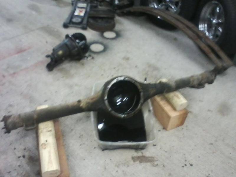

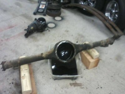

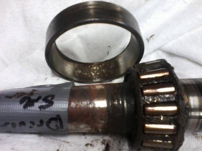

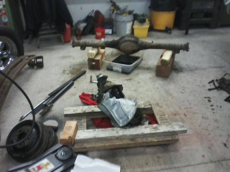

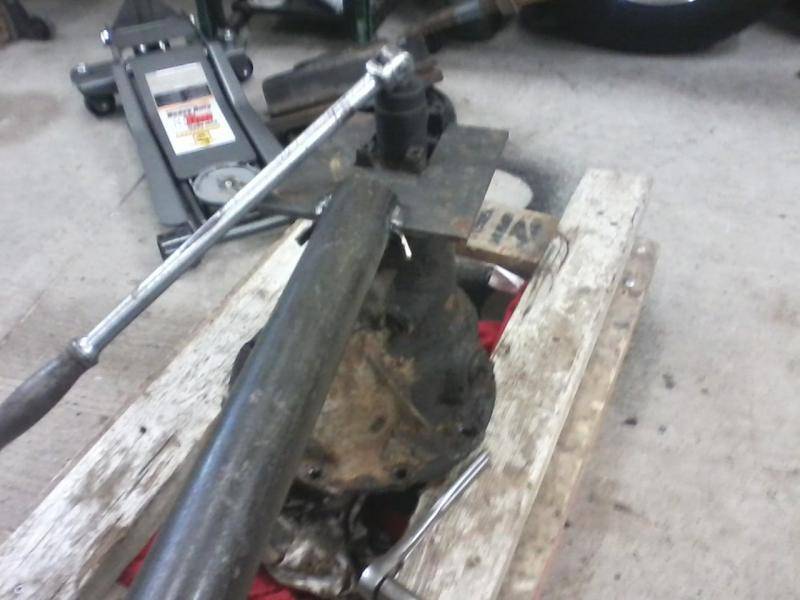

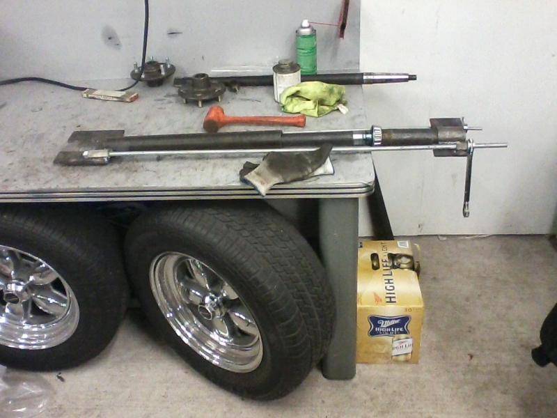

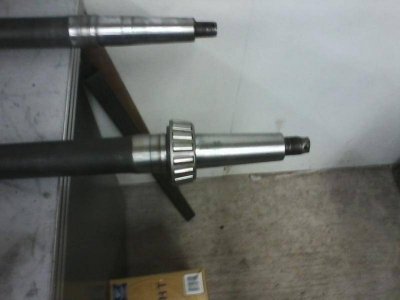

Well he we go, I took out the rear end and pulled the axles today. One bearing race showed signs of distress, Ordering new bearings, seals and gaskets from doc diff today, looking to polish and paint housing, new brakes , reinstall, and drive. I hear Green bearings are the devil, go with tapered and shim? 0301141110-00.jpg0301141113-00.jpg0301141116-00.jpg0301141123-00.jpg0301141144-00.jpg0301141219-00.jpg0301141219-01.jpg0301141221-00.jpg

64 is last year for tapered axle hubs. I picked up a whole housing out of a 65 New Yorker wagon less the center section. For 75.00 bucks I thought I would give it a shot to see if it works.
I am ordering new bearings with doc diff. I am going with the tapered bearings. I don't mind the tapered axles. Once I rebuild the rear, I wont have to dig into it again for quite sometime.

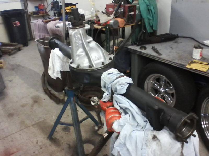

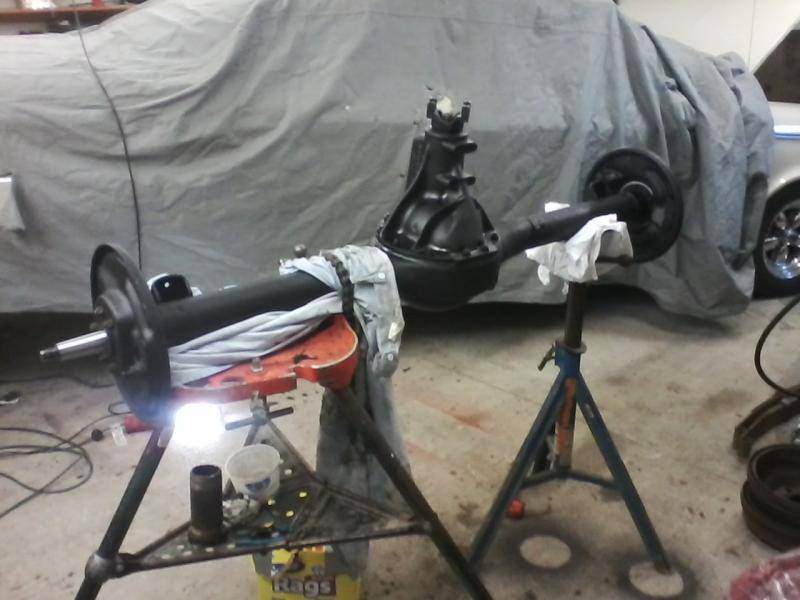

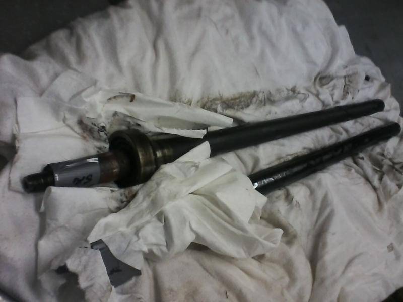

Doc diff did not have the bearings I needed for the tapered axles, found them on rock auto. All Timken. Slowly putting everything together, I enjoyed rebuilding the rear end and the sure grip. Great learning experience. Still waiting on the brake assemblies.0314141456-02.jpg0314141505-00.jpg0314141400-00.jpg0314141635-00.jpg0314141636-00.jpg
