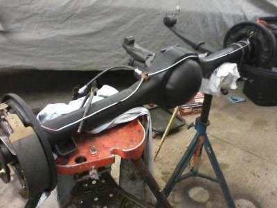

Rebuilding rearend

I could use someone with some rear end experience. How much resistance should there be when the rear end is all together? Drums are not on, and it is still on the bench. I can turn it with my hands at the yoke, but turning it at the axle flange seems to be hard. Is it because of the sure grip is working? I put a drill on the yoke nut and the axles spin smooth, everything seems smooth. If anybody has an extra rear end out in there garage, I would appreciate if they could give it a spin. Thanks Jake
Looking good man, its always nice when you do something to this standard and you know its like new.
Jake, nice job on the housing. How did you clean it up so nice?
I had a local mopar guru install a sure grip in my 741 carrier and re-bearing the axles at the same time. Just got to get the housing blasted and painted / coated.
I noticed that your wheel studs are tack welded to the hubs... is this normal?
The rotating torque should be done without the chuck mounted in the case. It doesn't include the axles... With new pinion bearings and a new seal it should be between 20 and 25 pounds of rotating torque. This is not done with a torque wrench - it's a special type of torque wrench.
