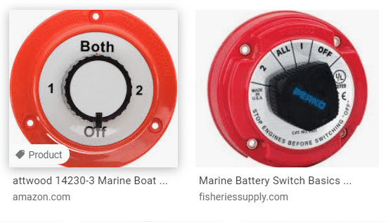

Did he not wire in a battery switch like this?
If not, it's a good idea so you can isolate the house battery form the starting battery.
Trying to figure that out, he just passed away, so I'm flying blind. There are colrhersey switches to each engine, I haven't found any to isolate the starting battery
I'm not familiar with "colrhersey" switches. Almost every battery selector switch that I've seen has been within a few feet of the batteries. I think I've seen one around a console. He might not have put one in. You just have to trace the wires and see. Homebuilt/wired stuff can be a hell of a puzzle to figure out.
I meant Cole hersey, it's that disconnect switch on the back of race cars, etc. Yes, I will be tracing wires. I'm gonna seperate it
