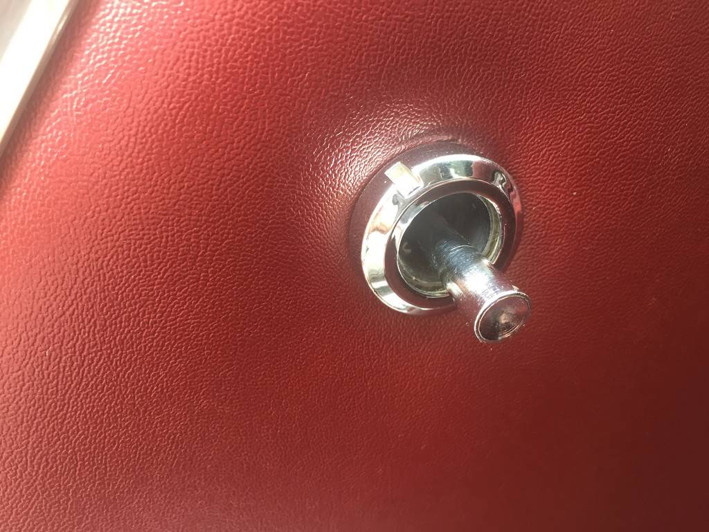

Assuming this is a door mounted control, there's also a spring metal retainer that holds the control in place when the door panel is off. Pry that off and push the control into the door. Unbolt the mirror and pull it and the cables/control out.
The control was flopping around so I'll have to look for that spring. Someone took the regulators out of the car.

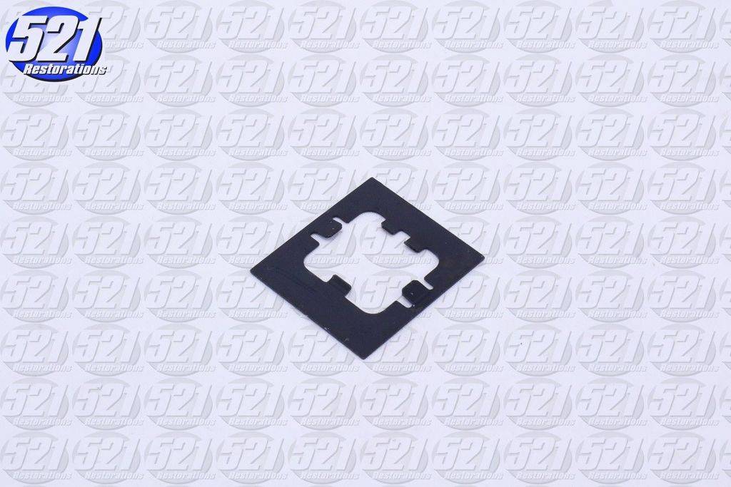

It's not a big deal if it's gone.
Mopar Remote Mirror Control Knob Mounting Clip Washer GTX Cuda Charger SuperBee | eBay

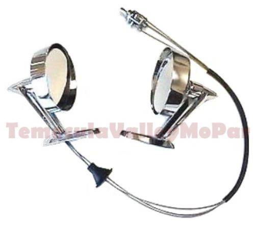

I assume the mirror looks like this one and the controller is in the door. The mirror would be mounted on the door.

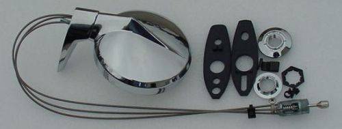

I believe this one has the controller in the dash. I've never dealt with them, so yes, it looks like a bigger controller and it would seem to me that you would have to disconnect the cables to get them through into the dash. This would be a mirror mounted on the fender.
I guess the question is if the OP has a door mounted controller or a dash mounted controller and what year did that change and then which models had what.
I believe this one has the controller in the dash. I've never dealt with them, so yes, it looks like a bigger controller and it would seem to me that you would have to disconnect the cables to get them through the door jamb.

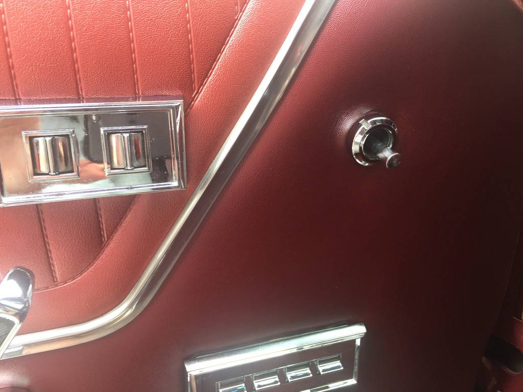

I had to remove the cables from the controls. The mounting location is different than my non remote mirror;
Vs
It's definitely mounted back further for the remote mirror. I do have the extra doors if I want to use them. Have to decide what to do.
