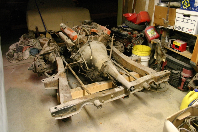

You can remove the Stub frame on a C-body but it is much bigger that the K-member that you are use to.
The Factory Service Manual outlines the procedure.
On the AB&E you pull the torsion bars, upper control arms and shocks then it is just the 4-bolts and the trans crossmember
On a C-body there is at least a dozen bolts just for the frame another dozes screws for the wheel liners. Good thing the torsion bars and upper control arms can stay.
Once seperated that assembly probably weighs twice as much as it would in a AB or E

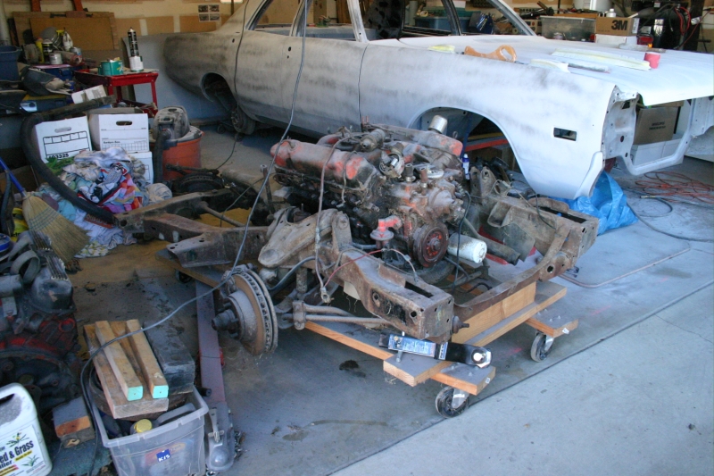

Here is a view of it removed
and another
No idea what else may be involved, bumpers etc but the factory service manual may better outline it.

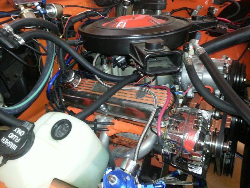

Here is a conversion on a 318 that I did.
No real problems, but I can tell you you will need some extra spacers of different thicknesses to make everything align.
