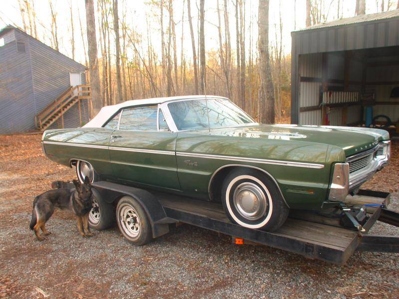

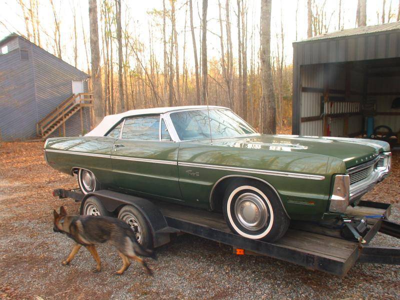

Here's the car in question, by the way...when I first brought it home on '06.
