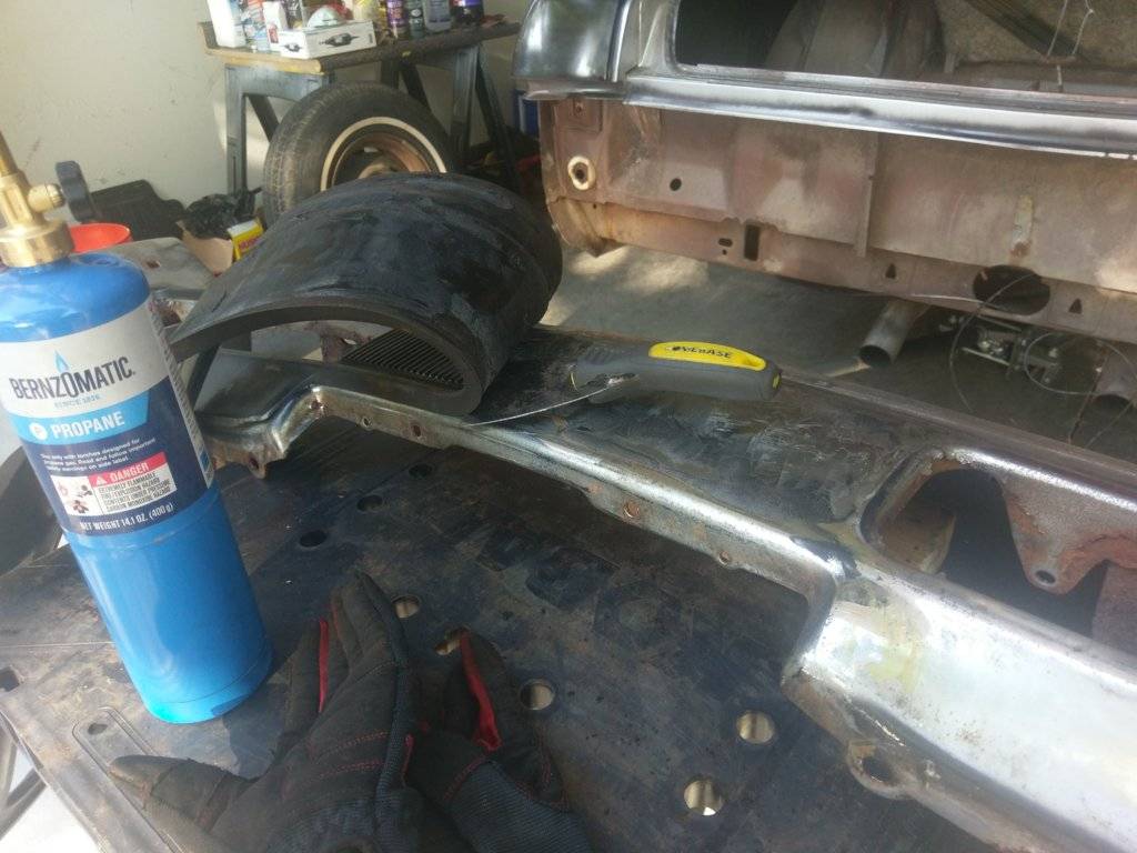

Hi, that is why I am taking it off in the first place to have rechromed.You should have a clean bumper, but it may need to be rechromed. I am dreading that on my rebuild. See my avatar.
Thanks for the replies. I have been over ever inch of the bumper looking for evidence that maybe fasteners had simply rusted off, but cannot feel any indents or bumps. It needs to come off one way or the other for rechroming (local company can cerekote a chrome finish), but it goes in an oven to 500 degrees, so applique has to come off. If it does not come off cleanly, I can live with the bumper being all chrome.
Sorry, not convinced.
It is never going to be exactly like chrome, because it isn't chrome

Now, (respectfully) go and get that bumper properly rechromed, not some powdercoat/paint process. You'll be so much happier for so much longer if you do it right.
