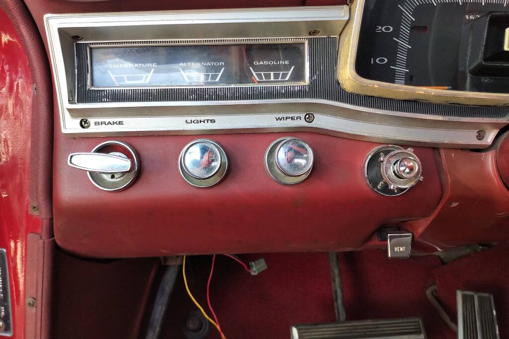

When I posted some pictures of the Auto Pilot controls on my 66 Sports Fury, I noticed how crappy the trim around my speedometer looked(see photo). I really don't know how it happened but it seems to have peeled done to the plastic.
Is there a simple fix that any of you have come up with?
