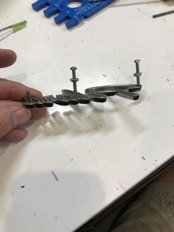

Drilled the holes out to 7/64. Filed down the ends of a 6-32 machine screw and was able to screw it in the hole. They seem pretty tight. Tomorrow I will cut the head off, double nut it, put JB weld on the threads and screw it back in. Since it is a good tight fit I think the epoxy will set up enough to keep it from moving. If they last through the polishing and detailing, then I may be good.

Nice job, well thought out.:thumbsup:

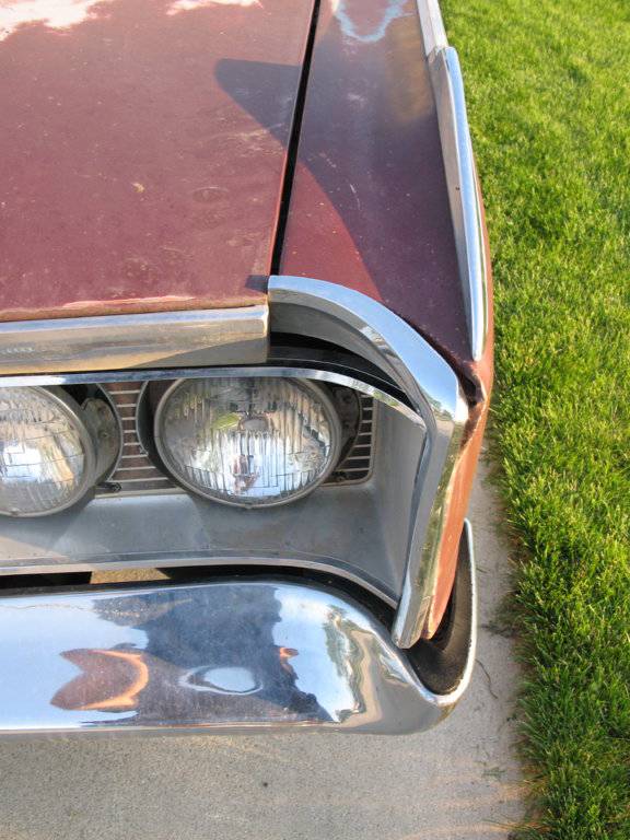

The front piece may hav been from hitting something.

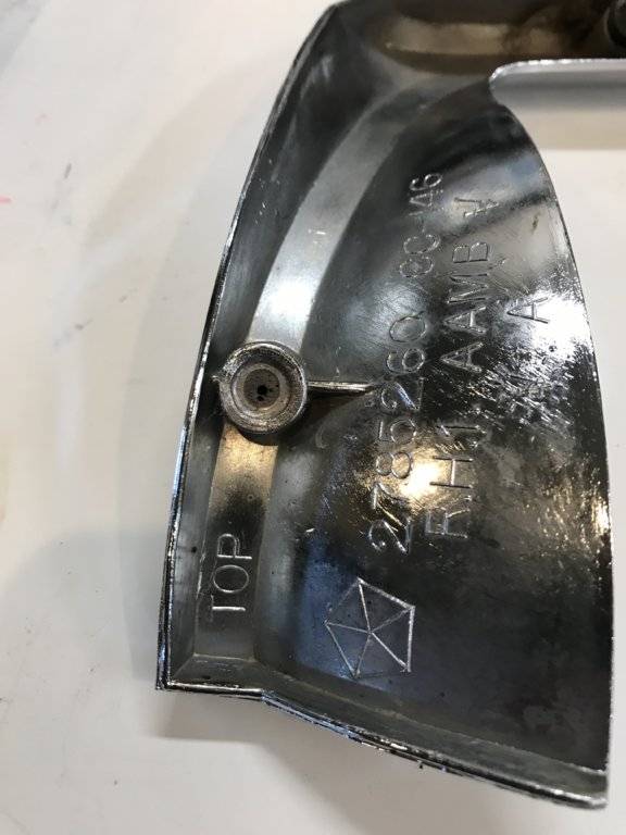

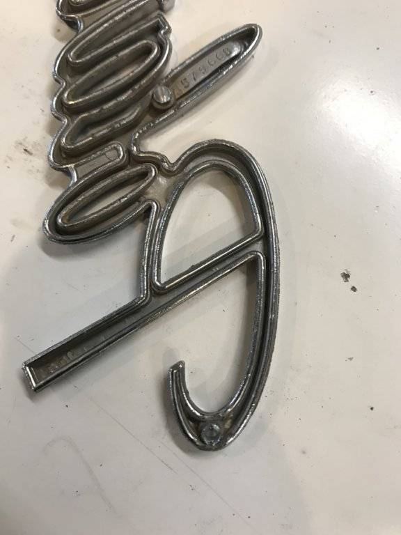

This one was bent so had to be replaced the other one was still straight but broke the top peg off.
