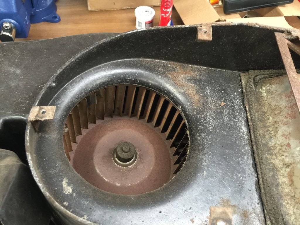

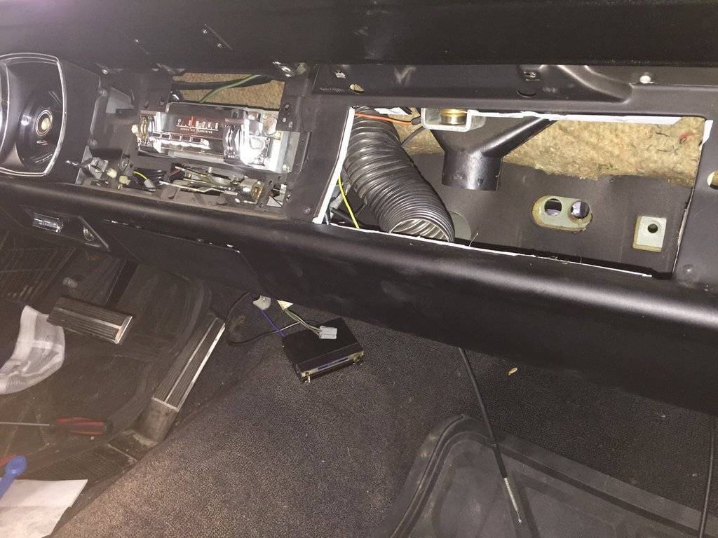

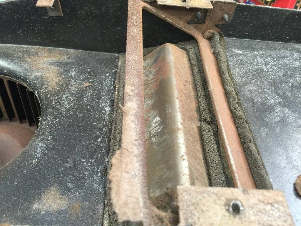

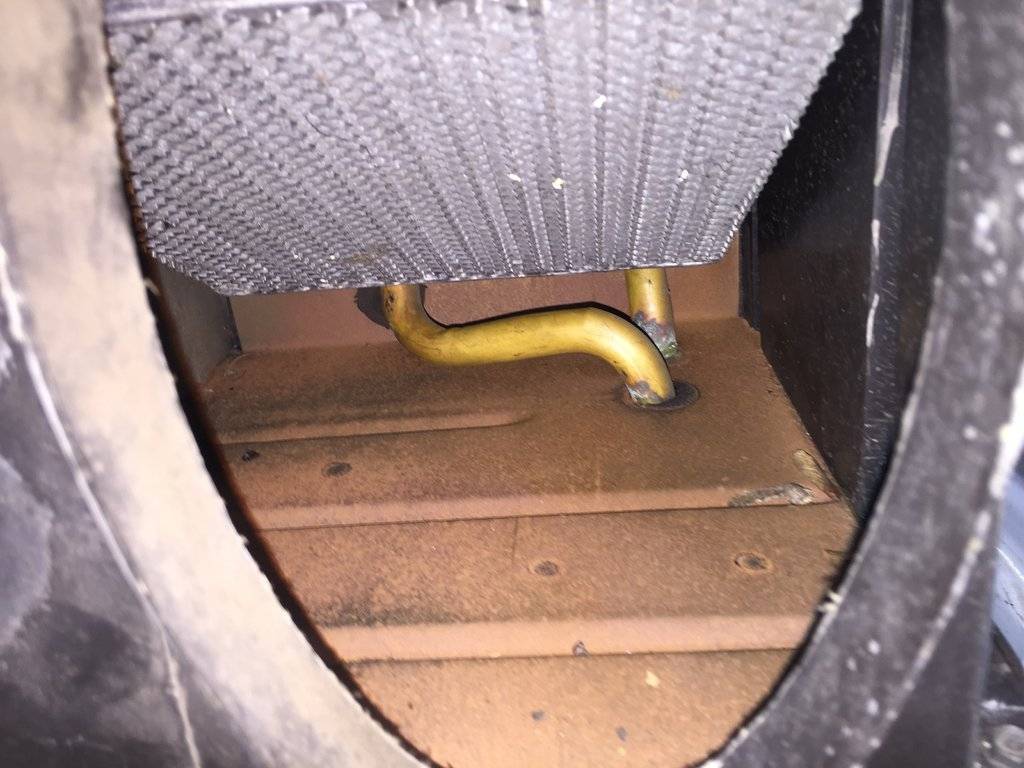

Hi all, haven't been on for years, but now I'm back! I am knees deep in my hearter box & core refurbishing on my 1967 Dodge Polara "E" 383 car. When you put on the heat, your nose and eyes were burning! I thought mouse nest, but it was actually the fibers from the spent insulation. Pulling it was not easy...Acually once the glove box was out it wasn't bad, but that was the WORST part was I ruined my glove box, so I'm going to try to rebuilt it with gluse, new cardboard & paint. I was hoping to find a replacement on line, but no luck there. (If anyone has any suggestions).
Posted some pics where I'm currently at. I'm thinking of painting the inside of the heater box with black high temp paint (Again, if anyone has any suggestions). I ordered a new Spectrum core (non-AC) from Rock Auto. Like everything I do its a slow process because I work 6 days a week and rediculous hours at my job (I work at a Chrysler/Dodge/Ram dealership in sales), but I will try to keep posting with more pics! Now looking for seals & gaskets kit for the heater box (And once again, if anyone has any suggestions).

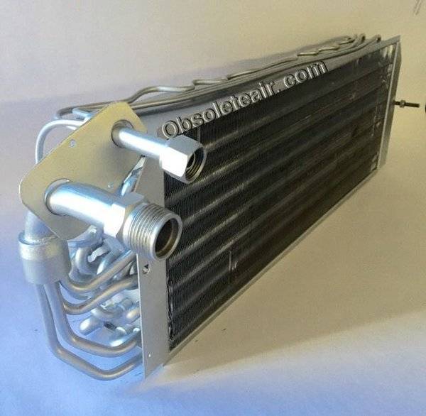

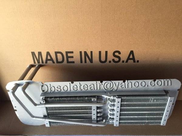

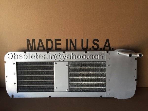

As of right now, the only replacement option is Obsolete Air's piece.
1970 1971 1972 1973 Chrysler Imperial Plymouth Fury GTX Heater Core Air conditioning
The heater core looks like this with two cores.
BTW, they also have the evaporator. That's something that I searched high and low for a couple years ago.
1970 1971 1972 1973 Chrysler Newport / New Yorker / E Class / New Yorker 5th Ave Evaporator

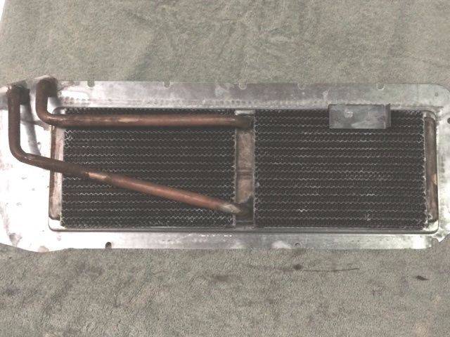

I should have been clearer.
That really isn't what the original looks like. I don't have a pic from when mine was apart, but it looked similar to this one. I would assume that this is configured like this so there is less loss of heat as the water flows across the core.
It looks to me like that replacement is just two smaller, generic cores put together to make it work.
