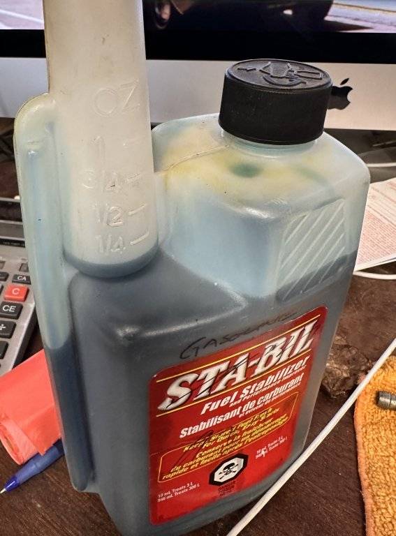

I remember it being 1oz to 5 gallon of fuel. I just picked up a litre of Pennzoil Marine Premium Plus.
Going to start using it this weekend, if rain holds off.
Steve: You should still use marine two-cycle oil - even in your 100LL gas. There are many benefits - regardless of the octane level of the gas in your tank.
Thanks for the advice RIP and Matt. I reread all the comments on the use of 2 cycle oil on the Chrysler 300 Club site and concur that use of the 2 cycle oil has plenty of additional benefits. I already bought some 2 cycle oil based on that advice before I decided to use the 100LL aviation fuel.

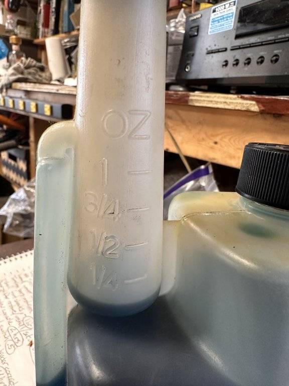

So today I ordered a container to make accurate measurements for the correct ratio:
Two Stroke Fuel Gas Mixer Mixing Measuring Container Bottle 2 Cycle Oil Engine 719249210001 | eBay
Use one ounce for each five gallons of fuel. One oz. per four gallons is too much.
I never did the premeasure thing. If the tank is less than 1/4 full at fill up it’s 2 glugs for the E body and 3 glugs for the Imps.:thumbsup:
I prefer more accurate numbers. One ounce per five gallons equals 1.5 percent. Much easier to remember.
