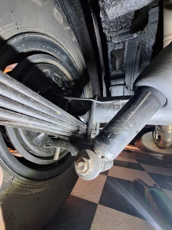

I went with the 6 to replace my 5-1/2, but then added my 1/2 spring from my original pack because I liked the 1/2 spring idea. It was a last minute decision. I figured it would add a little bit of extra help as when I road trip, the trunk is usually full.

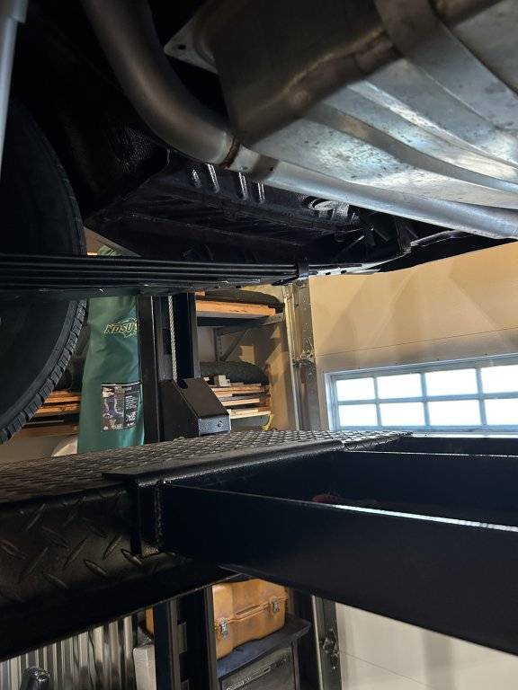

In my experience, leaf springs are pretty easy to modify and get good results. I’ve messed with many leaf springs on a number of 4x4s, and on my old mopars when I used to daily drive them. You can cold beat some arch back into them with good results. You need to disassemble them and beat each leaf individually. Just don’t go overboard. Take a free arch measurement before you start so you can add how ever much arch you think will fix it, and make both sides the same. Another thing I’ve done to firm up springs that are really soft or only had the minimum amount of leaves is to find a pair of donor spring that you can rob the main leaf from. Cut the eyes off of the donor main right where the curl starts, you want the leaf as long as possible without any of the eye left. Once there, you add this leaf to your pack immediately below the main. This gives your main leaf good support from eye to eye and will resist the S bend where the main is unsupported by the lower pack.
Obviously if your springs are rusty, damaged /bent from impact, or are obviously junk, this is not what you want to do. BUT, if your springs are overall in good shape but have lost their oomph from 60 years of use, this is any easy and cheap way to get your car off of the ground without compromising safety. Springs modified by you, or a spring shop will last as long as you own your car.
Travis..
After you get new springs ditch those air shocks, or even sooner! The rear shock crossmember on these cars was not meant for the stress air shocks can put on it. If the springs are that bad you are already transferring all that load to the crossmember.
