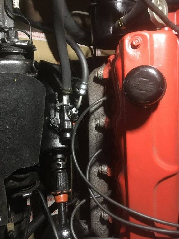

I’ve just finished installing ar reman AC Delco unit in the ‘66 Fury.
Partnr 19321310 (steering gear) & partnr 19146735 (high pressure hose).
Quality & finish are quite good. The necessary seals are also supplied.
Time will tell if the steering box will hold up, but for now i’m quite happy with my purchase.
When installing you’ll need to reuse the current mounting hardware and existing high pressure hose connection as this is not part of the kit.
It’s also easier to remove the box from the bottom of the engine compartment iso the top (as per the FSM).
I hope this helps.
Kristof

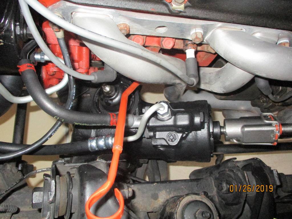

I just installed the pricey-but-perfect Firm Feel box in my 70 300. When you install it, there's ZERO worry that the person rebuilding it in Thailand took a cig break and left some parts out when he/she returned.
But once you've bought it, had is shipped, and then ship your core back to get your $250 core charge back (cost me $95 FL to OR) you'll be out $500 or so.
For me, it was money very well spent. Others may think I'm crazy. You pays your monies and you makes your choices.

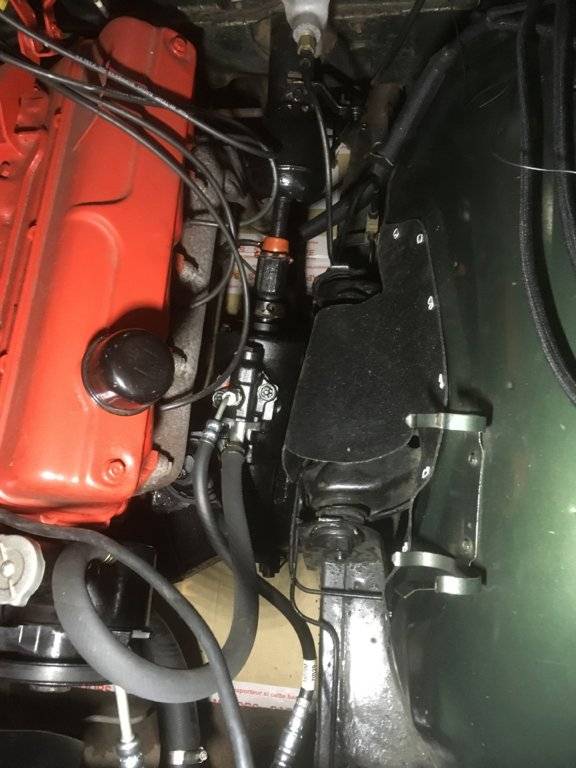

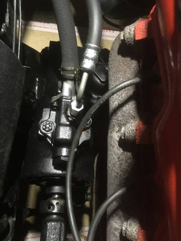

Hi David, here are the pictures you requested.
I made an error in my original post. You need to reuse the bit where the low pressure hose connects to (silver part on the front), the high pressure hose is just screwed in.
Kristof, thank you for your pics and your explanation and updated info. Did the steering gear steer w/ any additional effort. Great photos.
Hi David, the FSM explains quite well what you need to do and disconnect. The most difficult thing was to loosen all the bolts, which took considerable effort, especially the big nut connecting the steering gear to the linkage (pitman arm, i think is the correct therm...), you’ll need a 1 5/16 spanner for this.
You’ll also need to remove the steering linkages in order to remove the box from below.
Removal took me 2 evenings. Cleanup and installation 1 afternoon...
