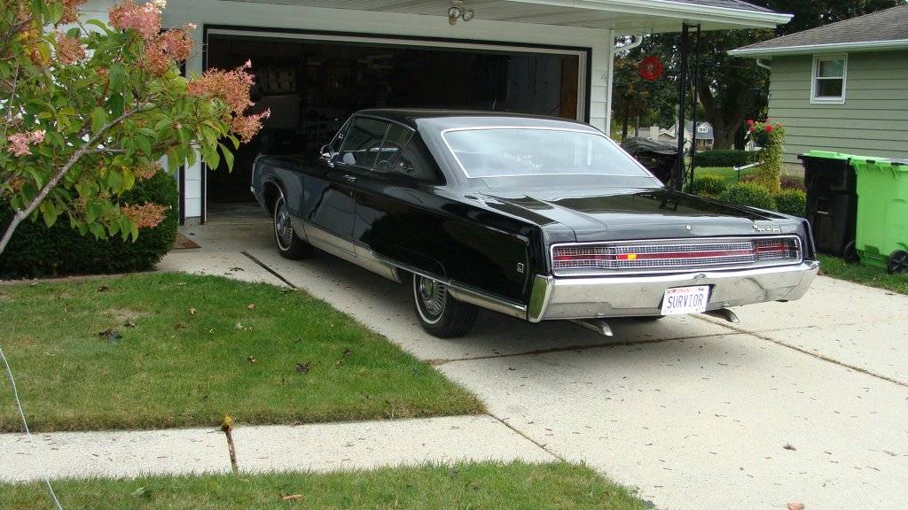

*** UPDATE**** well, I finished up today, never did get my alternator back from the rebuild shop, so I took the one off my GOLD NewYorker and swapped, I started the car and it ran near perfect, the idle was up 1/4 turn, I suspect the new chain had something to do with that. I would say, not a bad job to tackle but experience does help . The old chain while worn didn't have any chipped or broken teeth, not bad for 75K mile car. I did keep the AC compressor off this time, just bought a smaller belt. we'll see how that goes.
