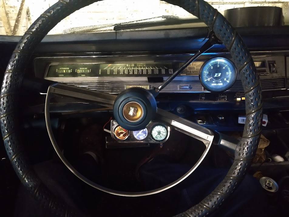

Inspires me! I've been replacing sundry incandescent bulbs w LEDs, fixing switches and cleaning them up. Repaired the right hand upper circuit board w a dab of copper tape to get the turn signal lamp working, and will eventually break out some more $$ and get the solid state 5V power supply for the gas gauge. I've buzzed Redline once or twice about our currently defunct '66, but this '68 dash is a LOT easier for me to work on at home. IFF I still get bounce out of the speedometer after I install the 34 tooth pinion gear this weekend, I might want to have the mechanism redone.... For now, I just use some humble old Stewart Warner and Clark Brothers gauges for the tachometer,
Gertrude's Instrument Lighting, Work in Progress​
oil pressure, coolant temperature and system voltage. I bypassed the ammeter, but know of a surplus electronics shop nearby that might have a workable voltage meter that would fit where the ammeter abides. Alas, there is only so much time in a day, and so many dollars in a bank account.... I LOVE your CLOCK! THAT I also want to get!
