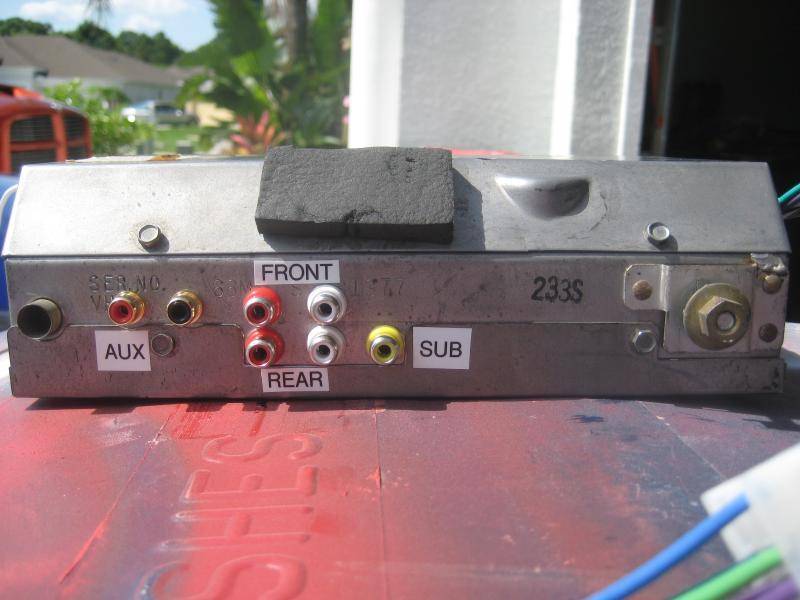

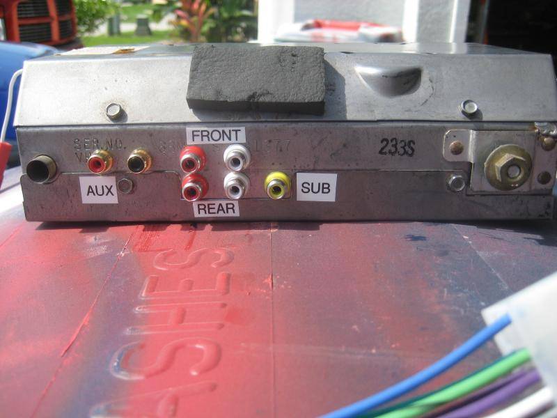

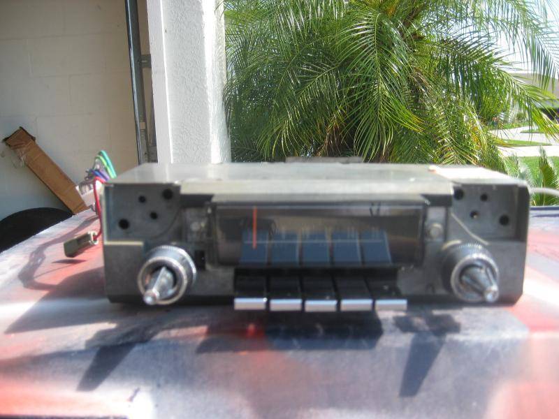

Here's the radio for my 66 Charger that SM Electro-Tech did for me. They cleaned it up really good and even checked to see if the EL lighting in the radio still worked. Which it does. I'm hoping to get it into the place that did my seats this week. I'm going with 2 JL 8.8 marine speakers and 200 watt amp in the fold down to the trunk. Should fill the charger with some nice sound. I ran a cable for the Aux in along the dash, into the channel along the driver's door, then across with the wiring for the center console and shifter then into the center console to plug my phone in for tunes. I made sure i had enough cable so I could pull the phone all the way out of the center console and still be connected to the radio.

I don't plan to use an amp unless I am not happy with the sound I get from the dual voice coil 4x10 and 6x9 I just installed. Then I may opt for an 8" sub just to round out the sound. It was only $15 more for the three line outs so I decided I would rather have it if I need it. My preference would be not to have to install an amp although I am not against it if deemed necessary.
As far as the connectors, they are all 3.5mm in size. How many contacts each has is not clear or documented from what I can find. I know the Microphone plug that came with the kit has two contacts. And I also expect the AUX (LINE IN) to use two contacts. I would guess the line outs use a dual contact 3.5mm connector since it is split into F/R. Never seen it done this way though, I have always seen RED/WHITE RCA plugs when working with an amplifier.
if you're not using an amp then for the speakers you'll use the wires coming out of the radio that go to the white connector. if you were going to an amp the preferred method of connecting to the amp would be rca cables. but there are amps that can be connected with a 3.5mm jack. you typically need one amp per 3.5mm jack. it looks like they use 3.5mm jacks and not rca for the line out.
I think all amps are gonna use RCA. I guess they make a splitter cable???

Kellycom suggested earlier they make an amp that uses this style connector, I have never seen one but I have limited experience with amps and it's been 15 years since I worked with an amp. Figured I would just make an adaptor for it if needed.
Thanks for the tips on the mic location, I'd like it to be as hidden and functional as possible. Sun visor could work well as it may be hidden while in the up position.
http://www.amazon.com/Pyle-PLMPA35-2-Channel-300-Watt-Amplifier/dp/B004HJ931M amp w/3.5mm input
or http://www.amazon.com/RiteAV-Feet-3-5mm-Stereo-Cable/dp/B000V0G2C4 to convert the 3.5mm to rca for input into an amp with rca connectors. I used one of those cables for my AUX in. Well it was 1 6' rca to 3.5mm and 2 6' 3.5mm cables to route it where I wanted it in the center console.
you can get them in 15 ft or longer (http://www.amazon.com/Premium-feet-Series-3-5mm-22AWG/dp/B002KJCFAW). which you'll need if you mount the amp in the trunk.
