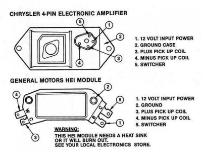

If you ignition is working ie. no miss no fouling there in no magic bullet. Period but I don't have to tell you that because your picture shows you know what is really happening.
